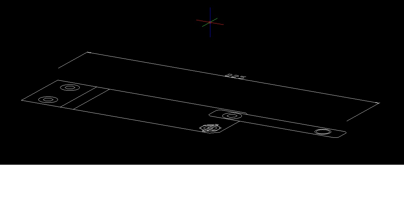

Hi all,
Seem to be having an issue with snapping and z position when doing flatshot.
I have the WCS set to world, I look at the top view. Do a flat shot and snap it to the grid. It clicks down and ends up anywhere in the z axis. On this occasion (shown here) is 1.75mm up in Z. If I select the block that is made from the flatshot it tells me in the properties that the z value is 0?!?!?!?
Then you add a dimensions and it's not even attached to the block!
I've done a variety of things like setting the WCS using 3 points and using 3 points from the flatshot block, that makes no difference, I've tried exporting the block direct from flatshot interface and bringing it back in, that didn't work.
Any ideas?
Cheers

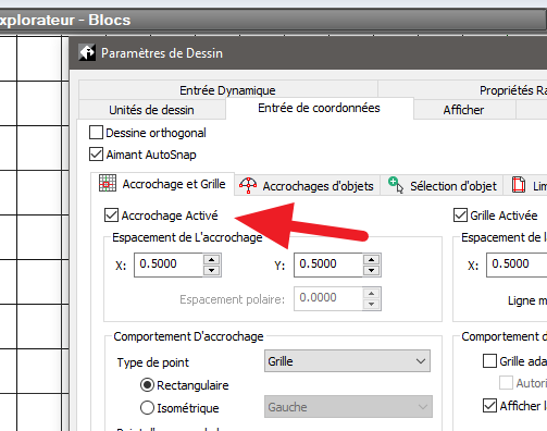

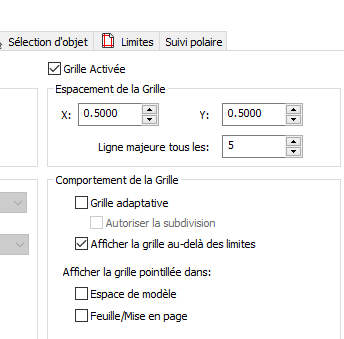

I tested the snap fonction and all is ok that's work! to activate your grid snap you must use Tools > drawing parameters and Coordinate entries > Snap and Grid > Grid activated !

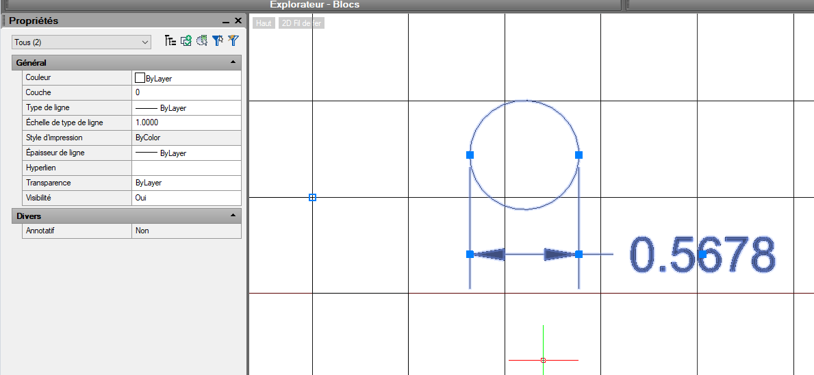

And here you can see the dimensioning :
My block is snapping on the grid and my dimension is correctly snapping on the quadrant
No problem !

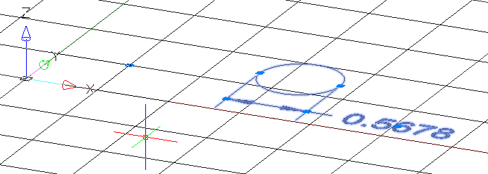

So if you rotate the view are the dimensions actually touching the circle?
In a plan view it looks that way. I have grid snaps on when I do the flatshot. So 3d solid, flatshot command, and it gives you the view, you can export and bring it back in or just place in modelspace.
When I place down and dimension in modelspace, you rotate the model and dimensions don't touch the part, as my original image.
Cheers

I answer you! Warning the grid to be too small and Adaptative grid desactived !
The grid adaptative !

So if I move the flatshot to be at z zero my dimensions don't attach to the part. Attached is the part I'm using. Adaptive grid is off and everything
Re: Floating dimensions and snapping
Posted: Thu Apr 24, 2025 7:20 am
Here is the correction of the block : https://www.dropbox.com/scl/fi/ohf0w9zy ... h9mlu&dl=0
Explications: With this new command you must save the created block on the computer and open it as DWG to verify the entities. .
Setup all entities on the ground Z = 0 and save it. Then import it on your original drawing as new block.
Why when you try to change the altitude didn't work : your block A$32D in your original file didn't change his parameters when you saved it when you closed the block editor.
So I exported your block out of the original file with a new name and removed all instance of A$32D block in your file. Saved the file/closed it and reopen it for reimport my new corrected block and all is ok now!

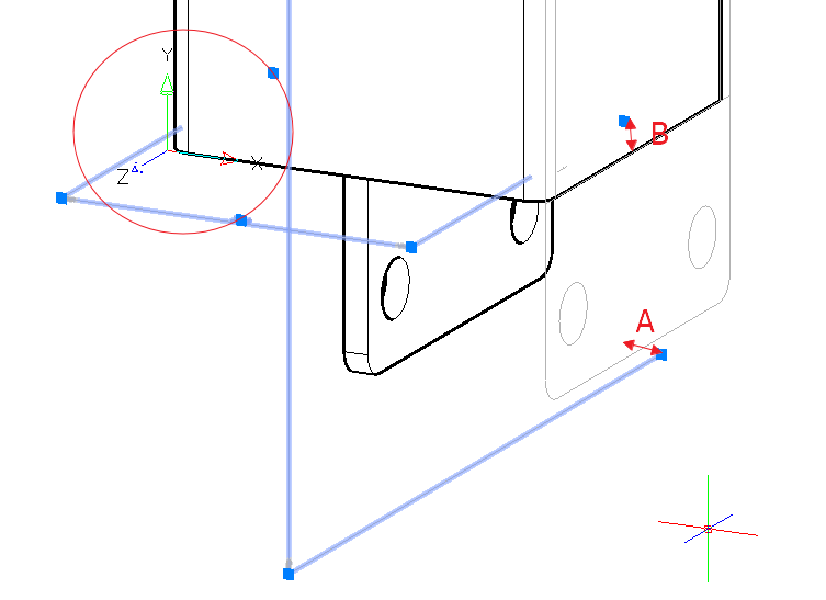

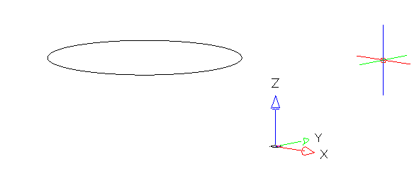

For the dimensions I search but I find uniquely an error from IntelliCAD :
2025-04-24 16 01 17.png (25.29 KiB) Viewed 22485 times
WHY DIMENSIONS IS NOT ON THE WORKPLAN AS ALL WORK ????? Why This gap A and B ??????
In this file the gap is around 5 mm !
Case A : I changed the workspace World UCS to the Block object but my dimension is not on the entities????
CASE B: I go the top view and I clicked dimension on the XY workspace as always but my dimension is over 5 mm gap ????
Posted: Thu Apr 24, 2025 8:30 am

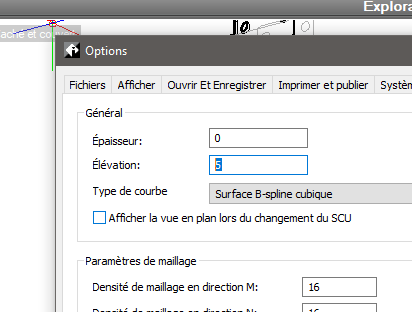

EUREKA : Your file has options here :
So you add 5 mm gap of hight !
But I created a new file and imported your corrected A$32D block and now the dimension are connected with your block !

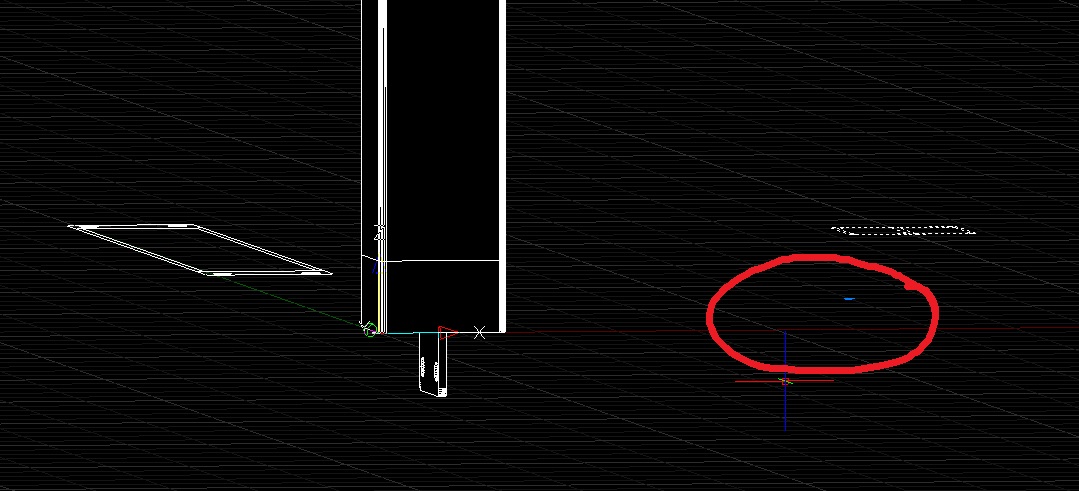

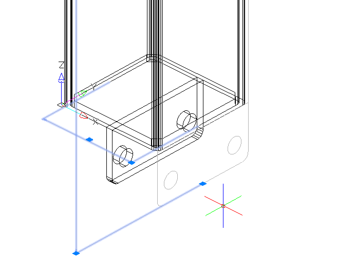

Thanks for looking at it but that makes no difference to the flatshot. If I export the flatshot, bring it back and mess about with it yes I can get it on z zero. I've even got the option to have the z input on the curser from the options, typed in z zero and it sits well off zero plane.
The block it generates seems to have some weird blue square miles off the bottom of it, that blue square is sat on the z zero plane, nothing else.
Weird No It's normal, this weird blue square is the origin of the block . But in block editor you can change the position of this UCS to this block.
To go in block editor, double click on the created flat block.
If you don't know what is a block and the editor, go the Help menu > CMS help F1.
