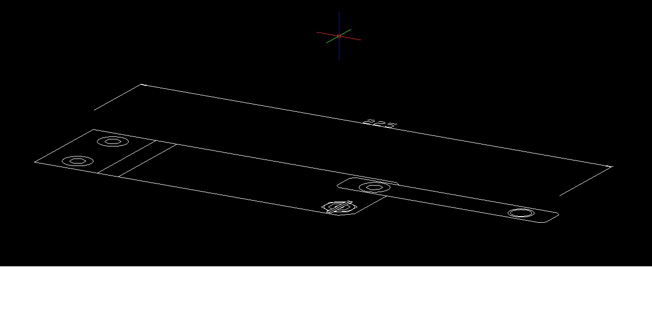

Hi all,
Seem to be having an issue with snapping and z position when doing flatshot.
I have the WCS set to world, I look at the top view. Do a flat shot and snap it to the grid. It clicks down and ends up anywhere in the z axis. On this occasion (shown here) is 1.75mm up in Z. If I select the block that is made from the flatshot it tells me in the properties that the z value is 0?!?!?!?
Then you add a dimensions and it's not even attached to the block!
I've done a variety of things like setting the WCS using 3 points and using 3 points from the flatshot block, that makes no difference, I've tried exporting the block direct from flatshot interface and bringing it back in, that didn't work.
Any ideas?
Cheers

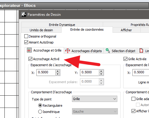

To attache the block on the grid , your grid must be great enough to be sawn as the block !
I tested the snap fonction and all is ok that's work! to activate your grid snap you must use Tools > drawing parameters and Coordinate entries > Snap and Grid > Grid activated !

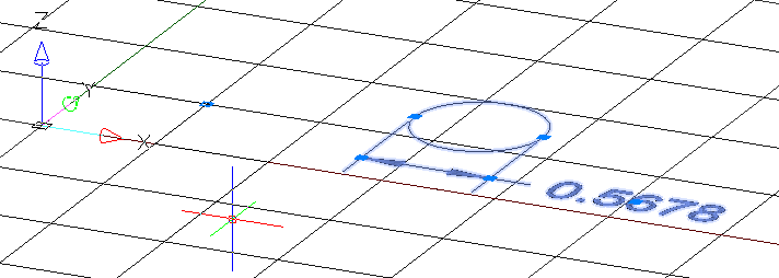

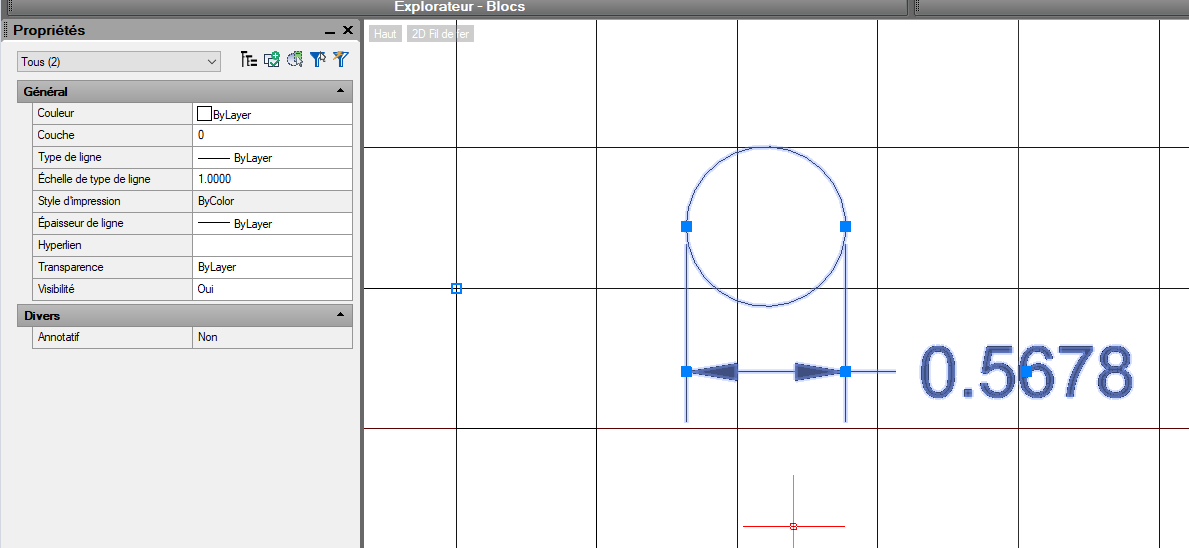

And here you can see the dimensioning :
My block is snapping on the grid and my dimension is correctly snapping on the quadrant
No problem !
Thanks Steve to show me this new "FLATSHOT" command I hadn't seen it ! Very usefull !
BUT AS I EXPLAIN ALL TIME : In 3D with IntelliCAD you must make a lot of experimentations to obtain a good result !
Me I use Blender for clear 3D entities !

So if you rotate the view are the dimensions actually touching the circle?
In a plan view it looks that way. I have grid snaps on when I do the flatshot. So 3d solid, flatshot command, and it gives you the view, you can export and bring it back in or just place in modelspace.
When I place down and dimension in modelspace, you rotate the model and dimensions don't touch the part, as my original image.
Cheers

I try to answer you :
>Do a flatshot
OK now
I answer you! Warning the grid to be too small and Adaptative grid desactived !
The grid adaptative !
You want 1.75mm altitude ?
Yes it's correct. If you click 2x on your block to enter in Block mode, This 2d transformation is always on the 0 level!
But you can place this block at all Z altitude of the grid dimension off'course! But deselect the snapping to change the altitude of your block !

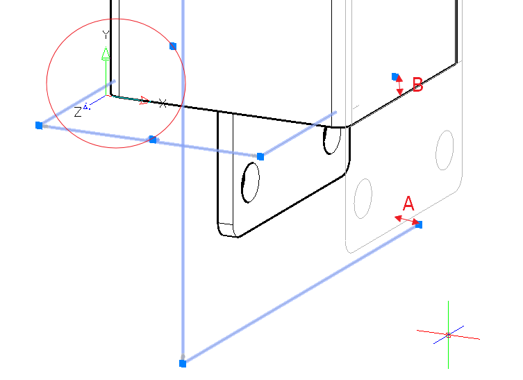

#12
For the dimensions I search but I find uniquely an error from IntelliCAD :
2025-04-24 16 01 17.png (25.29 KiB) Viewed 22470 times
WHY DIMENSIONS IS NOT ON THE WORKPLAN AS ALL WORK ????? Why This gap A and B ??????
In this file the gap is around 5 mm !
Case A : I changed the workspace World UCS to the Block object but my dimension is not on the entities????
CASE B: I go the top view and I clicked dimension on the XY workspace as always but my dimension is over 5 mm gap ????

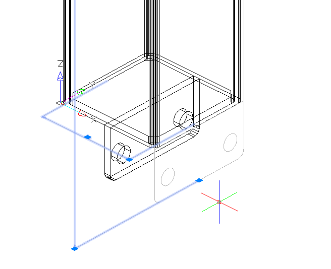

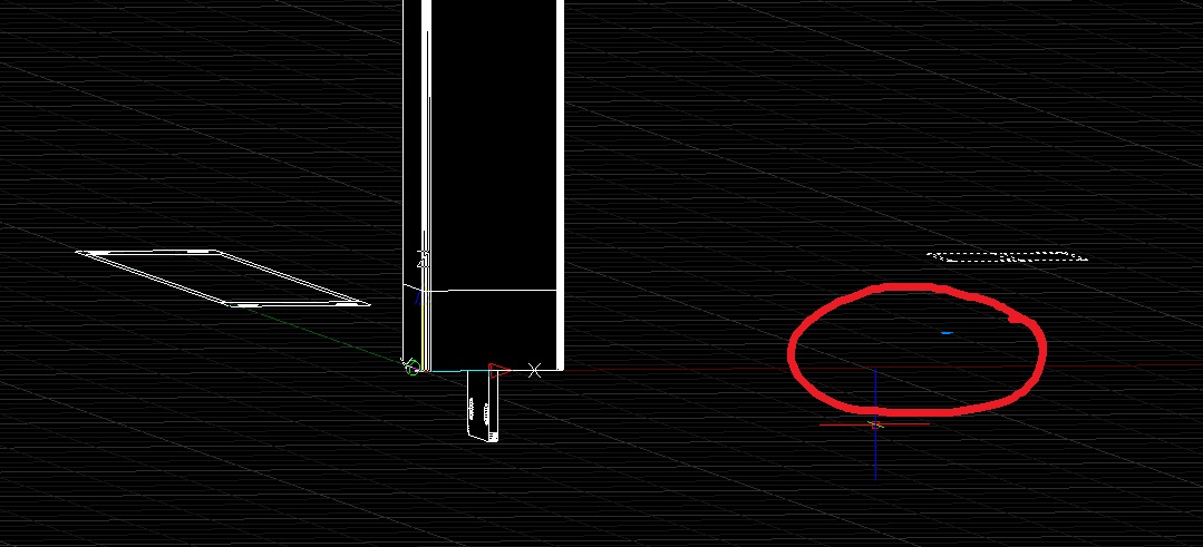

Thanks for looking at it but that makes no difference to the flatshot. If I export the flatshot, bring it back and mess about with it yes I can get it on z zero. I've even got the option to have the z input on the curser from the options, typed in z zero and it sits well off zero plane.
The block it generates seems to have some weird blue square miles off the bottom of it, that blue square is sat on the z zero plane, nothing else.

The flatshot cmd make always the same thing. The origin of this block is always at the same level of the block but where the 3Dshape UCS is.
Weird No It's normal, this weird blue square is the origin of the block . But in block editor you can change the position of this UCS to this block.
To go in block editor, double click on the created flat block.
