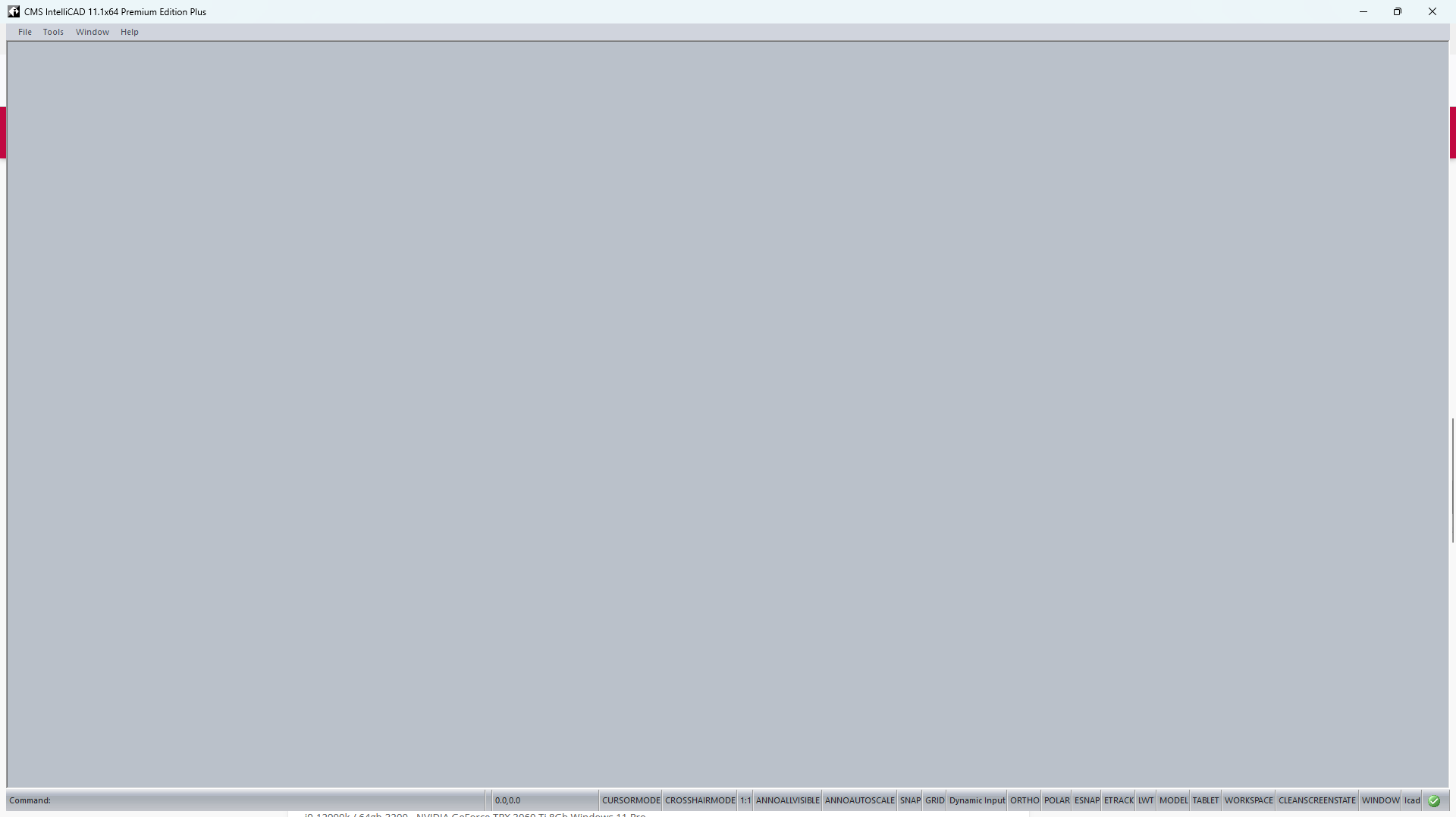

The suggested solutions did not work.
1. I know how to call up the Classic mode once the start is completed. What I want is to have the program start up in the classic mode each time without any additional commands required.
The STARTMODE 1 or 0 brought up a blank screen. What I wanted is a normal start without the black start screen when it first starts up.
Please advise how to accomplish these changes.

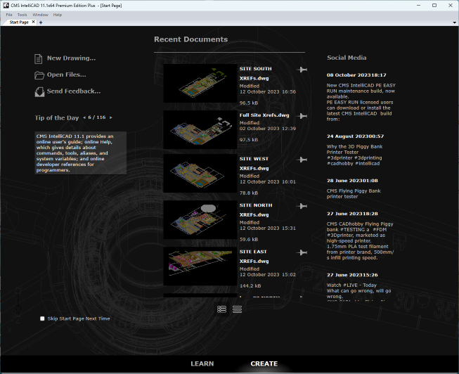

Posted: Thu Oct 12, 2023 10:06 am
To turn off the 'start page' tick the box in the lower left quadrant.
start page off.png (219.45 KiB) Viewed 8929 times
Icad should now start like this:
start page.png (29.12 KiB) Viewed 8928 times

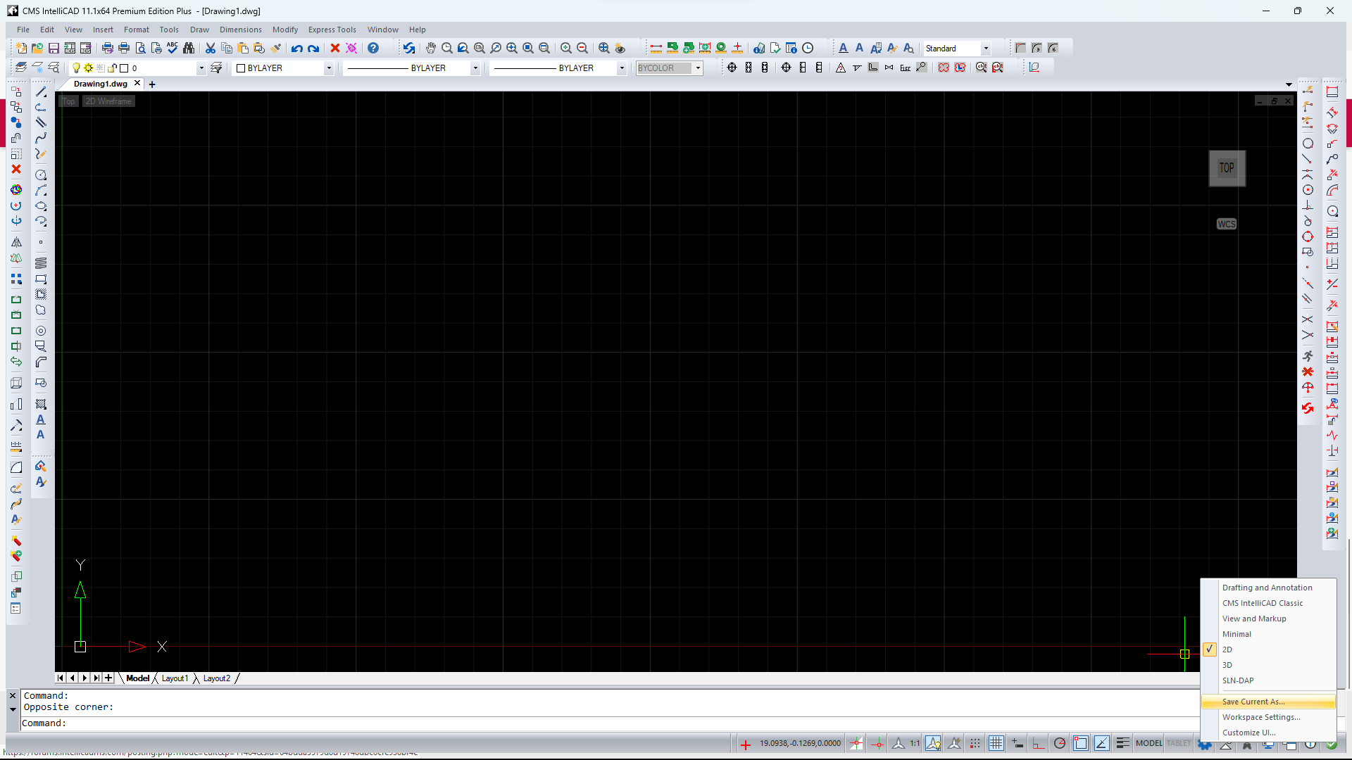

Re: Intellicad start up
Posted: Thu Oct 12, 2023 10:18 am
I too prefer the clasic view.
Open a new drawing and load ALL of the toolbars etc that you plan to use.
Locate them as you please.
Now save the workspace, name appropriately:
This is my setup for 2D general draughting, there is also a 3D variant aswell.
Exit Icad with your chosen workspace setup as the active setup. Icad should save both the startup page turned off & in the workspace last active.
HTH
Posted: Thu Oct 12, 2023 12:22 pm
Warning:
The System variable PRESERVEDEMPTYWORKSPACE must be < OFF > ou < 0 > to save the workspace when IntelliCAD is shutdown.
