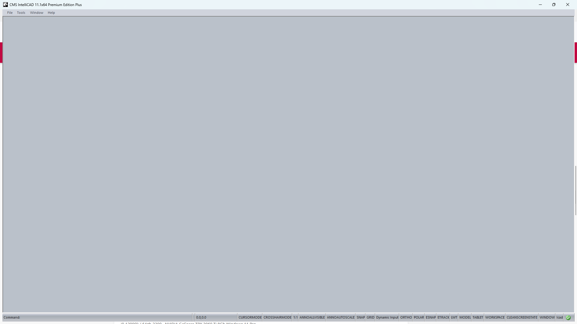

Re: Intellicad start up
The suggested solutions did not work.
1. I know how to call up the Classic mode once the start is completed. What I want is to have the program start up in the classic mode each time without any additional commands required.
The STARTMODE 1 or 0 brought up a blank screen. What I wanted is a normal start without the black start screen when it first starts up.
Please advise how to accomplish these changes.

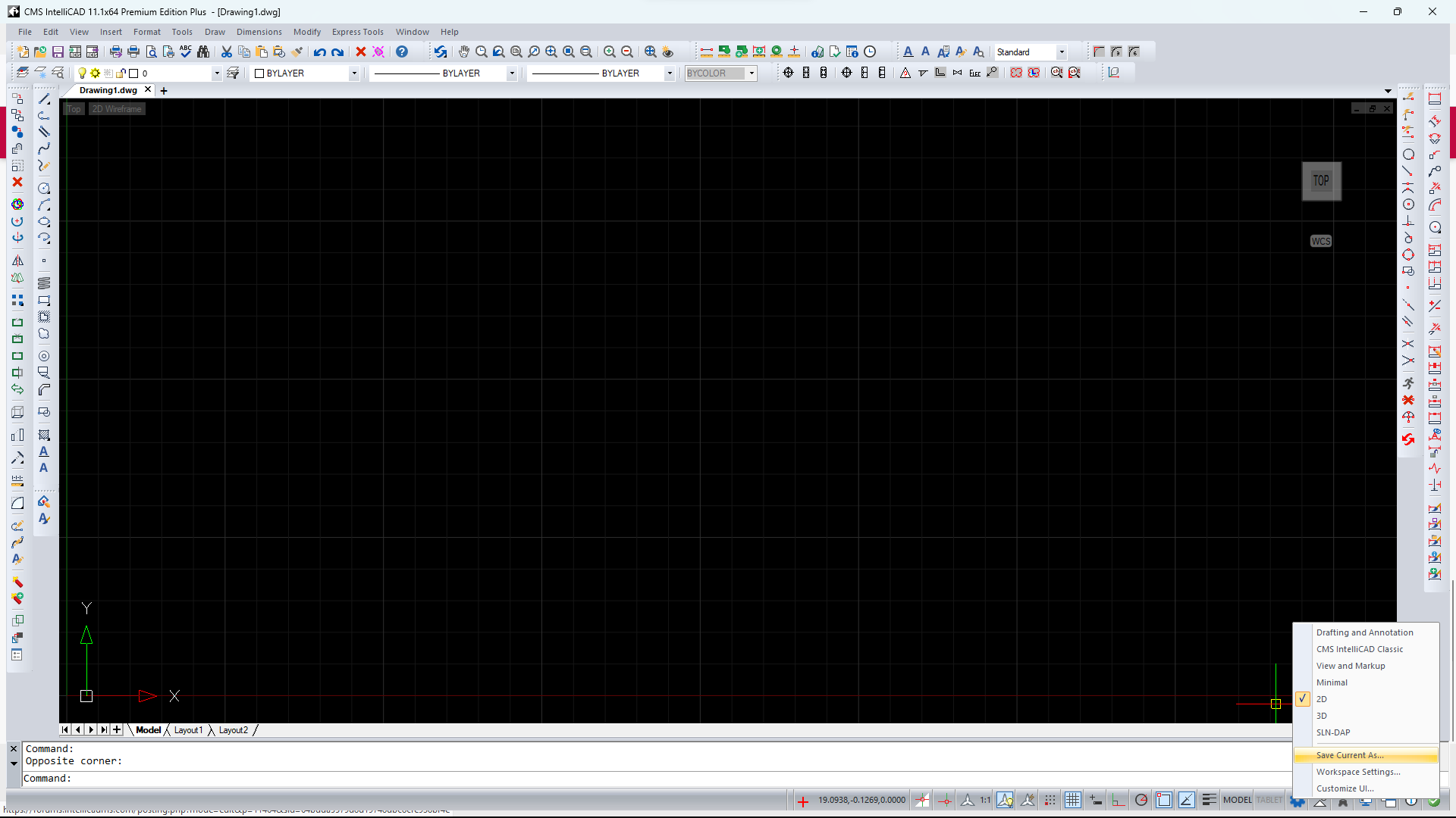

I too prefer the clasic view.
Open a new drawing and load ALL of the toolbars etc that you plan to use.
Locate them as you please.
Now save the workspace, name appropriately:
This is my setup for 2D general draughting, there is also a 3D variant aswell.
Exit Icad with your chosen workspace setup as the active setup. Icad should save both the startup page turned off & in the workspace last active.
HTH
