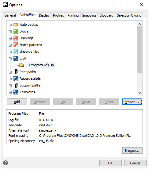

You can use the command OPTION -> Paths/Files to add any path to the file search path.
Then IntelliCAD can see them.
Something like this:

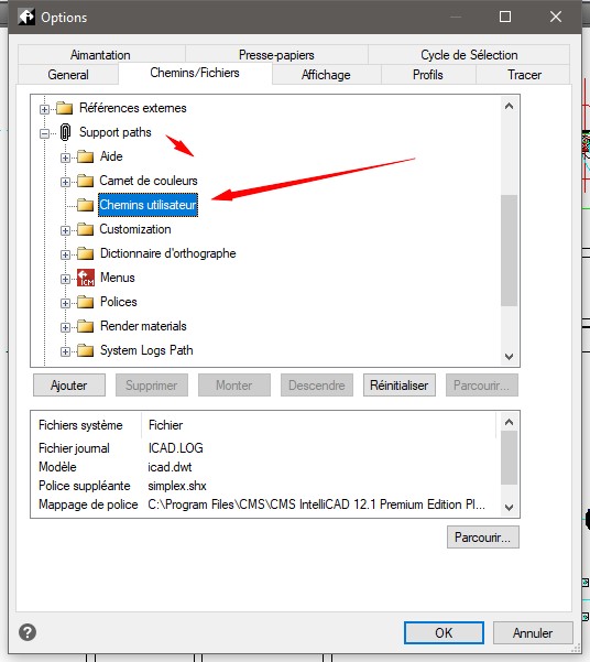

Try other folders.
Personally I use "Support Paths > User Paths":

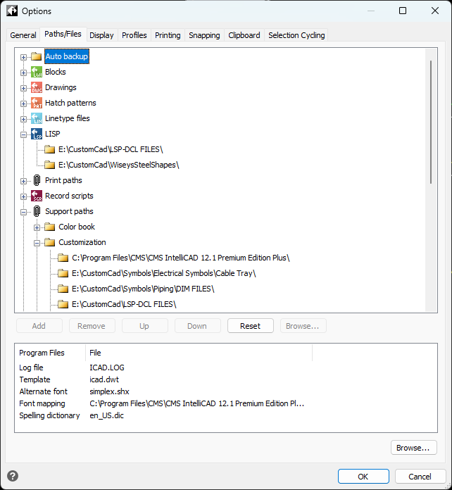

This is how my system is set up for lsp files in version 12.1 and appears to work fine.
Possibly put your 'icad.unt' file in one of these??

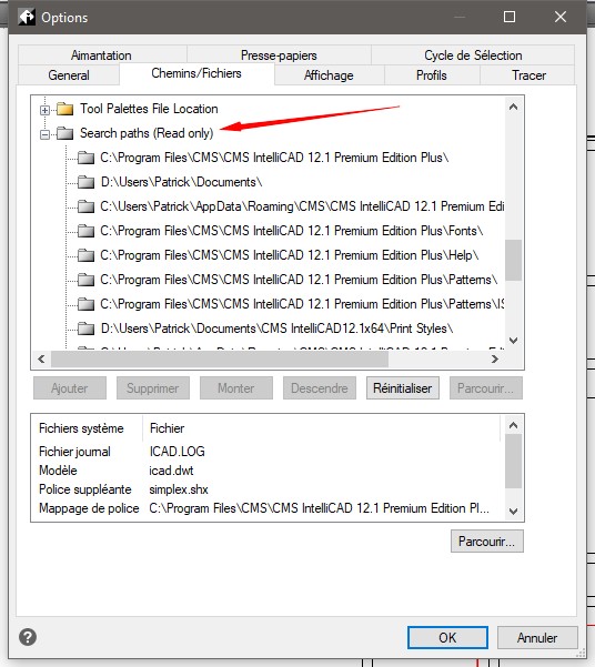

InGeomatics wrote: ↑
Wed Apr 17, 2024 7:06 am
In AutoCAD, you can just add it to the Support/Search Path and works perfectly.
To verify if your file is activated, look here after close/re-open your options:
If you see your folder it's ok for your lisp script.
Personnally here in France I use "support paths > menu" because the verification work.

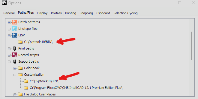

Posted: Wed Apr 17, 2024 11:55 am
Have a read here -> viewtopic.php?p=6791&sid=316efd9e7e9b38 ... 4bfc#p6791 <-
Should add the specified path to the begining of the list.
