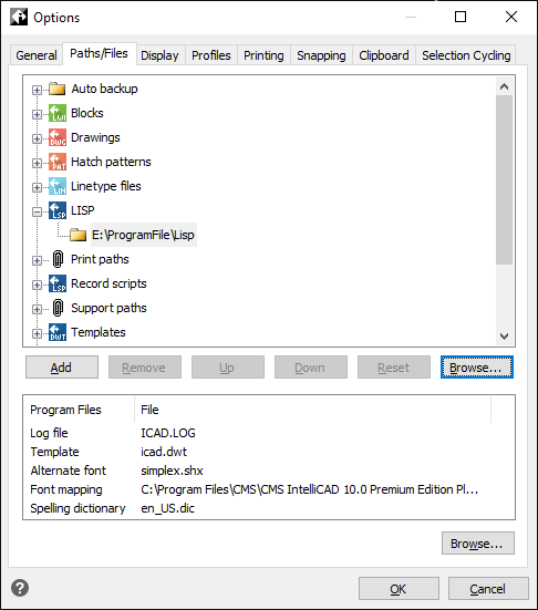

You can use the command OPTION -> Paths/Files to add any path to the file search path.
Then IntelliCAD can see them.
Something like this:
I try it, and as you can see in the other posts, does not work.

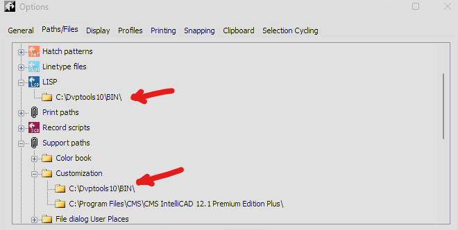

This is how my system is set up for lsp files in version 12.1 and appears to work fine.
Possibly put your 'icad.unt' file in one of these??

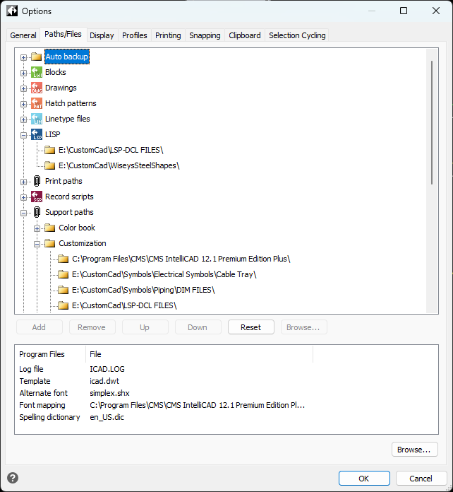

Another thought is to put your file location at the start of the search paths, that is Icad12.1 atm, but re-organise the paths to put yours at the front.

I agree with you, that must be the problem. In AutoCAD, you can reorganize the search paths.
But please, forgive my ignorance, is there a way to reorganize the search path in CMS IntelliCAD?
Please illuminate me.

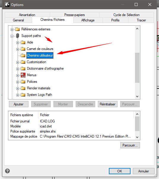

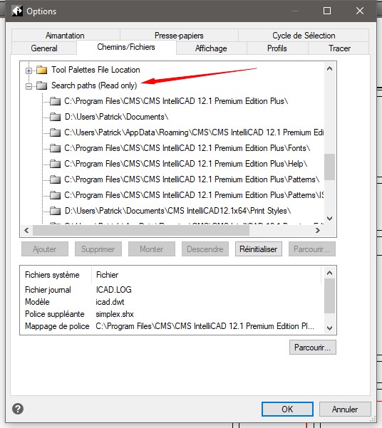

To verify if your file is activated, look here after close/re-open your options:
If you see your folder it's ok for your lisp script.
Personnally here in France I use "support paths > menu" because the verification work.
