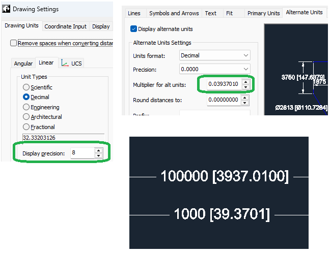

Hello,
I wanted to add imperial dimensions as an alternate unit using "Architectural" to convert from mm to inches.
The multiplier I need to use is 0.0393701, the problem is that the software doesn't allow me to enter this value because it uses less digits.
It changes this to 0.0394 and the problem is that this gives inaccurate imperial dimensions especially for large values.
Is there a solution to this?

You can increase the unit precision in your Drawing Settings → Units tab before entering the conversion factor.
