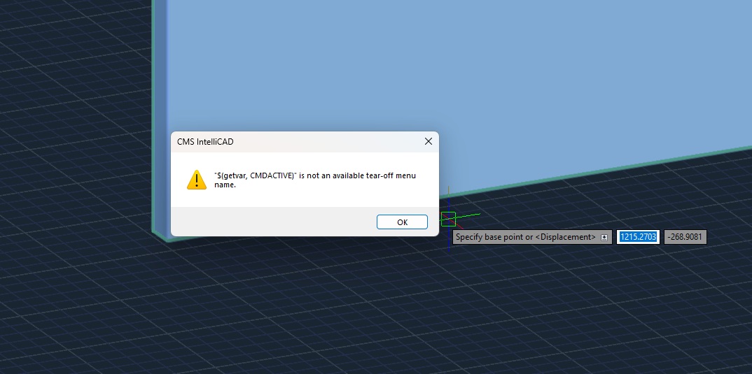

I'm trying to use the move command and select mid point using 'shift'. I get the error as shown attached. Latest version installed. Any ideas please?
Untitled.jpg Infinite Craft Game
It looks like IntelliCAD is having trouble with the midpoint snap using Shift. Make sure OSNAP is on and Midpoint is checked. Some versions don’t support Shift to select midpoints, so try hovering over the midpoint directly or entering coordinates manually. Restarting IntelliCAD or resetting settings can also help.

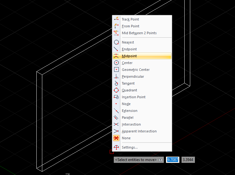

Are you using SHIFT+RIGHT CLICK to load the snaps menu?
shift menu.png (55.94 KiB) Viewed 8851 times
The same problem!
Icad 14.1 has been released and is a FREE upgrade. Try this and see if the error persists.
