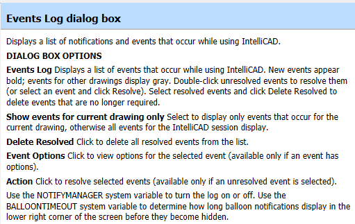

Hi, you can set the system variables of NOTIFYMANAGER and BALLOONTIMEOUT to control the dialog box.
Please refer to the attached image.
Events Log.png (30.43 KiB) Viewed 9614 times
