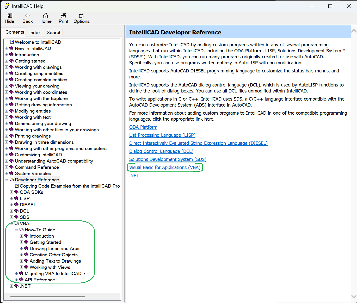

Re: IntelliCard VBA help is not available in my help topics
Posted: Mon Jul 14, 2025 8:38 am
It seems strange.
What version of IntelliCAD do you have?
Here's the contents of IntelliCAD help version 3.1 PE+
IntelliCAD VBA.png (168.05 KiB) Viewed 3449 times
Posted: Mon Jul 14, 2025 6:04 pm
Yes, maybe it's the difference between the Premium Edition (PE) and the Premium Edition Plus(PE+).
