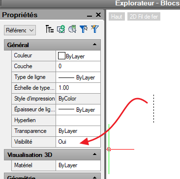

but vla-get-HasAttributes don't exist with Icad !
I want obtain this property :
2025-07-02 21 30 29.png (16.71 KiB) Viewed 8436 times

We don't need to use Lisp for that; IntelliCAD supplies three commands to hide and view objects.
- HIDEOBJECTS
- ISOLATEOBJECTS
- UNISOLATEOBJECTS
Re: How to change entity visibility with Intelli-lisp
Posted: Thu Jul 03, 2025 1:11 am
Ha yes with only HIDEOBJECTS in terminal it's ok. Thks Quan I searched for a long time with Visibility/Visible but I didn't find it...

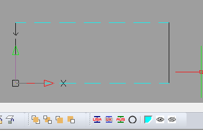

EDIT: Nickel/Chrome Quan! your prog work very good !
I added the two function in the same lisp file and added two buttons to hide/display objets
Here is the file now: https://1drv.ms/u/c/3e78343d1605325e/ET ... g?e=u6PUio
Blue is to create ConstructLine and eyes are to DisplayAll/Hide !
Very goog tools now because you Quan !
