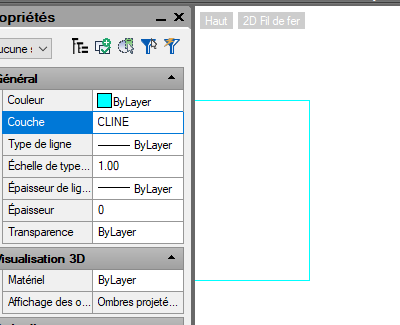

I found this but don't work yet....An idea? I create and place the entities selection on the CLINE layer but the color of the CLINE layer is not Cyan....just ByLayer.
The command _M don't assign the color in same time of his Make...???
Re: How add a new function to IntelliCAD
Indeed I hadn't see that... Sorry. All is ok now!

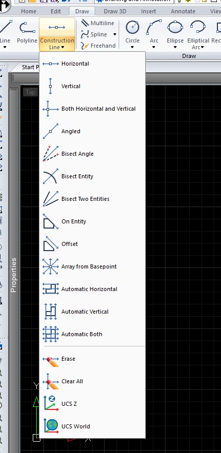

Today I added a feature: the type of CLINE will be "DASHED2" as in ACAD.
I added because Quan's answers two buttons to DisplayAll/Hide these objects.
If someone want this tool: https://1drv.ms/f/c/3e78343d1605325e/El ... A?e=IDp8XU
The Blue button is to create ConstructLines and eyes to DisplayAll/Hide the object in Block editor or default view.
I can explain how to add an Addons toolbar like this if needed :
