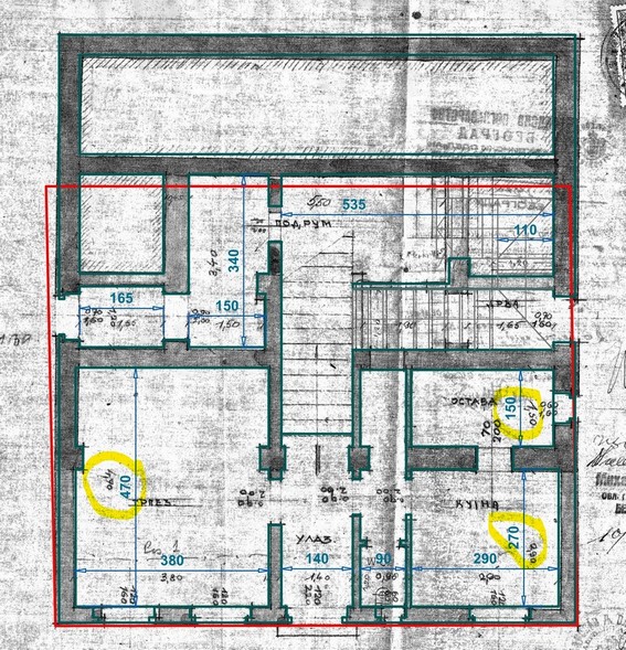

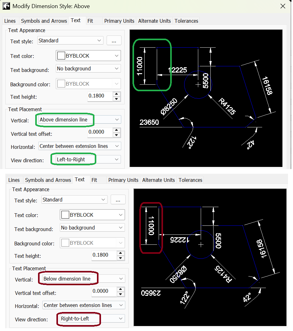

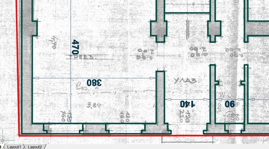

Does anyone know how to rotate vertical dimension text 180 degrees in the Dimensions Style Manager? I tried all combinations: to flip the text, to change the view direction, but nothing works. There must be some "catch 22".
I’m familiar with adjusting it in the Properties Dialog ("Text Rotation"), but I have many dimensions, so I should set it in Dimensions Style Manager.
Please see the picture - this I why I need the vertical dimension text to be rotated: I need the text to align with the old design (marked in yellow on the drawing).

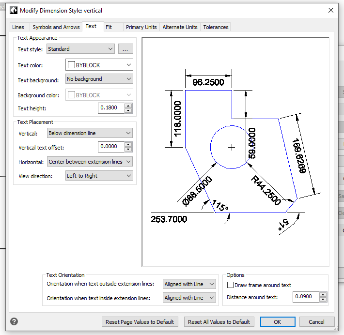

sln8458 wrote: ↑
Tue May 13, 2025 12:46 am
Hi Alexandra,
You may need to create 2 separate dimension styles.
One for Horizintal numbers and one for Vertical numbers.
So you can control how they are displayed.
YES, this is the only option so far.
