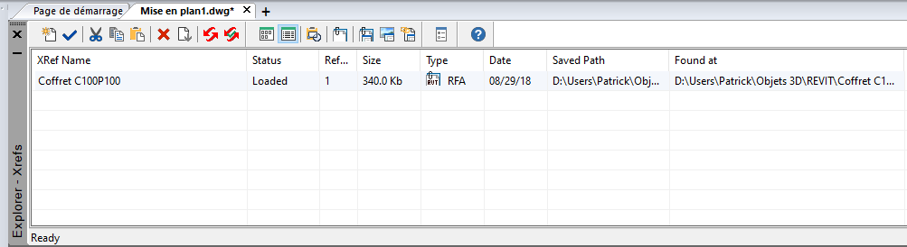

Example: Coffret C100P100.rfa
Then your resource is manageable by the REFs EXPLORER :

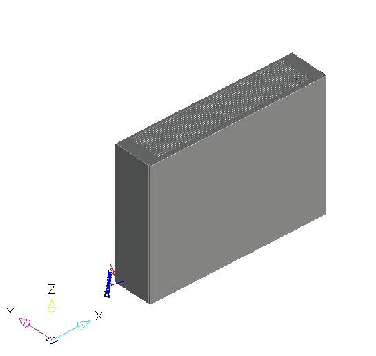

Yes there is a radiator :
But is it possible to have a parametric object like in REVIT, I don't know???

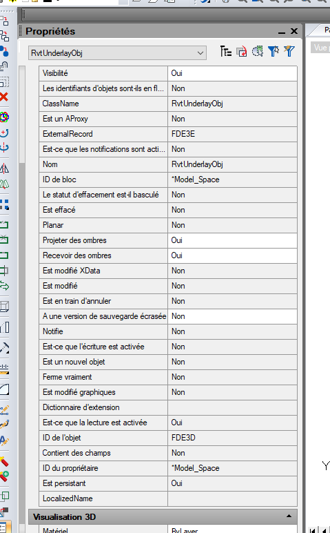

Look here in the properties panel :
A lot of values are not changeable !!! Because we are not in REVIT but this parametric values are there !
EDIT: I have learned that in REVIT there are System parameters and Shared parameters and etc...
System parameters are these parameters inactifs in IntelliCAD.
The .txt file is a shared parameters. In REVIT these values ared in a table and each column are used to change the shape of your radiator, not as parametric model but simply with custom parameters .
If you have a concrete post with d section et h hight, you create a custom parameter to d weight (or H) and connect it with a shared parameter. In the shared parameters editor, you select your model and D + H are actived and transfered to your drawing with these shared parameters.
