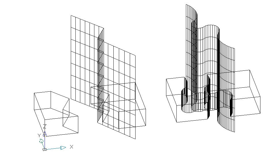

I have a question regarding SLICE with SURFACE command.
As I have learnt, Surface has to be extruded throughout EXTRUDE-MODE-SURFACE. And as such, SLICE works with spline:
SLICE command 01 Layout1a.jpg (219.58 KiB) Viewed 10914 times
My question is: How to make a surface out of PLINE, that would CORRECTLY slice 3DSOLID?

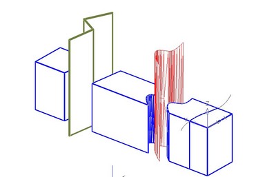

Do you know how can I slice with green surface (made out of PLINE), as shown on the picture below:

Re: SLICE command
Yes, so I drew the spline on the top of that end piece, used project curve from the tool bar and it gave me 4 curves on the solid block. The spline shape on the top and bottom faces and then two straight lines down the sides. Then I used network surface, select top and bottom curve, right click, select side curves, right click and it make the surface.
The used slice command, picked the solid, picked 'surface' from the command bar at the bottom of the screen, then picked the surface and it sliced it.

SLICE works on the latest v13.1 build.
If the slicing plane is generated from a PLINE extrusion, then such plane is created using the EXTRUDE command.
run SLICE > Pick solid to section > click "S" and select the Surface (the slicing plane) > press enter to keep both sides of the sliced solid.
