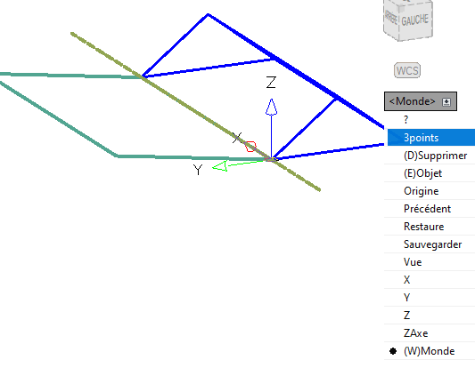

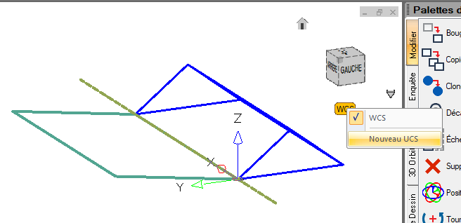

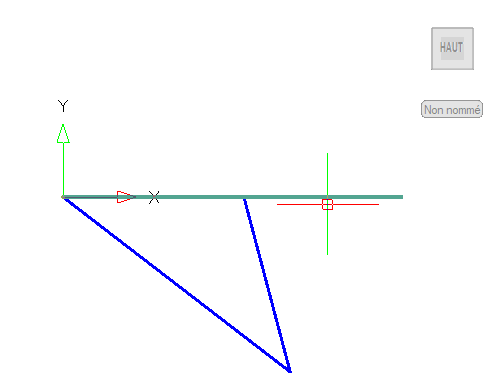

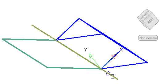

So with your example you must change your XY plan perpendiculare to the rotation axe like that;
Use the new UCS and choose with 3 points:
And then chose the first point where you want to install your UCS :

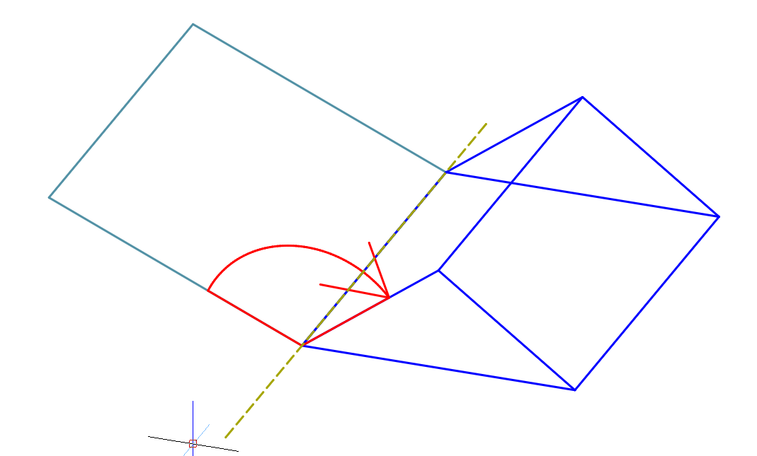

Re: ROTATE3D command
Posted: Sat Feb 01, 2025 1:24 pm
Like you see the XY is now the perpendiculare plan to the rotation axe.
Now if you click on "Haut" in my picture or "Top" in english.
You view change in front of your your rotation axe. It's easy, no?
So if you want rotate your green plan, select it and use the 2D rotate fonction and use the option "Base angle".
Choose the point of rotation and then "Base angle" and select the point of rotation as first and the extremity of your green plan as second.
Then chose the target of the second point and VoilĂ  !
Of course you must change UCS to the world after your rotation.

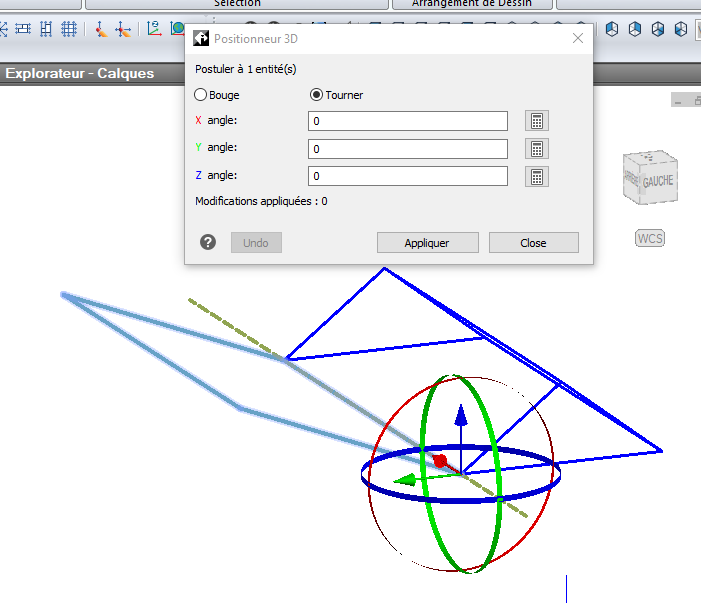

Alexandra there are a second method without UCS when your rotation axe is parallel to the World XYZ, use the 3D positioner :
But stay open the menu and select the red circle to rotate.
This method work but no precise !

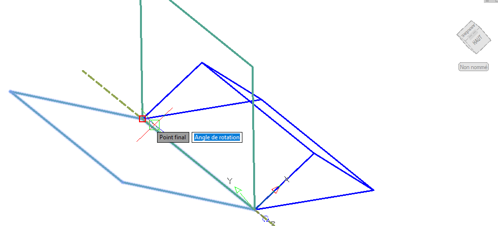

Command: _ROTATE3D
[FILter]/<Select entities to rotate>: 146582.5512,-10622.519,0
Entities in set: 1 found
Select axis by: [Entity/Last/View/Xaxis/Yaxis/Zaxis]/<2 Points>:
Select points for the axis as before:
Then:
[Reference]/<Rotation Angle>:
'Ref' (enter)
Now I get:
Reference Angle <0>:
Select the point on the rotation axis
then:
Second point: (for Angle <0>)
then:
New angle :
At this point things go astray, as the object rotates about the defined axis selecting a point to align with does not work!! :(
here is a video of what I did (might be easier to follow):
https://www.dropbox.com/scl/fi/395oe54w ... yo89b&dl=0

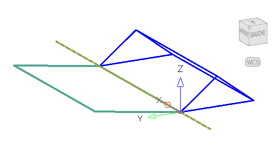

BUT I succeeded I found the solution :
I thought about the problem of snapping to points and I understood that it was the XY plane of the reference frame that worked.
So the solution is to create a UCS reference frame by placing its origin on the rotation point.
Then we use the 3D rotation in the new UCS and then we choose the reference on the line starting on the rotation point of our green plane and for the 3rd point the target point. And the rotation is done correctly :
Warning: The firts point of the axe of rotation define the plan XY where the snapping of point is defined.
The point sectected here is where the perpendicualre plan of snapping is activated !

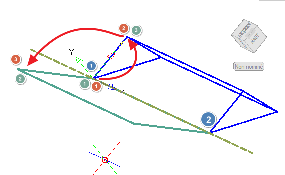

First: creation of the new UCS :
1 : Order for UCS in red !
2nd : Definition of the rotation axe with the 3D rotation command:
2 : Order for rotation axe in bleu !
3st: creation of the reference angle with the reference parameter :
3 : Order for Reference of angle in green !

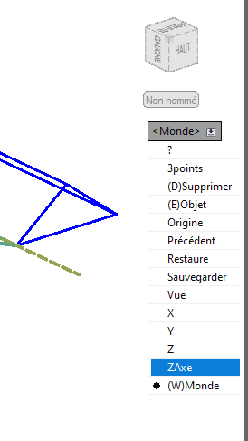

Posted: Mon Feb 03, 2025 11:23 am
Well, my initial problem with changing the UCS was with the layout of my building. It is not perpendicular; therefore it would be very difficult to set the "Z" value to align to the axis of rotation.
But when you create your UCS, let use with Z axe instead of 3 points and choose the rotation axe only :
