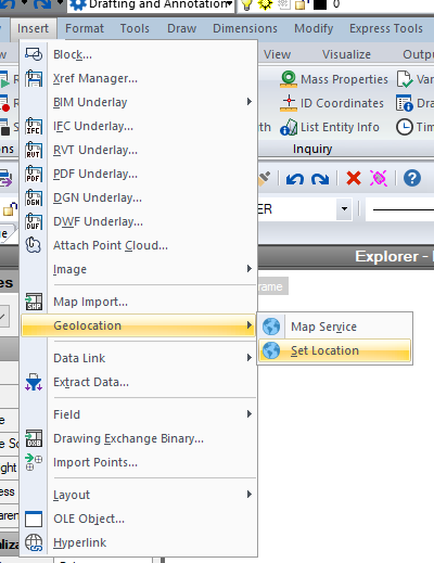

What is your IntelliCAD release please? You can use the tools in IntelliVAD v13 in :
In this menu :

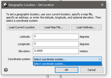

In blue set the location system to EPSG of your choice where you live (5th colonm) !
And then setup lattitude and longitude and Voilà!

The problem, it´s that, in my country uses EPSG 5367, and 8908. And, they are no exists in this list.
