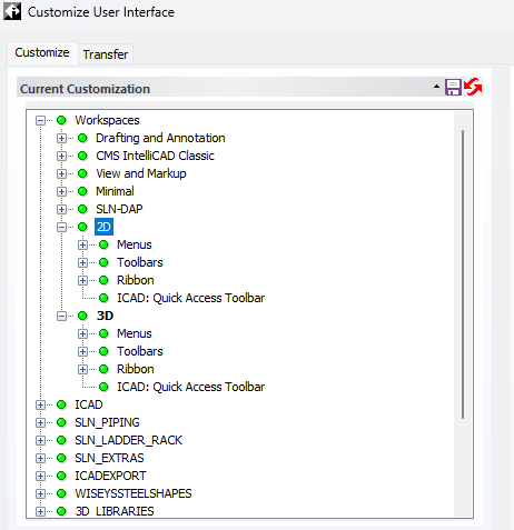

My work around for toolbar layouts uses Workspaces.
These can be copied/Transfered across from an old cui file in the Customise User Interface.

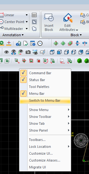

Can you explain a little what you mean by 'Classic Layout' ?
If you mean using toolbars in place of the Ribbon. Place your mouse over an empty area of the main menu (to the right of HELP) and right click and select switch to menu bar.
(note: it you add a toolbar with different Workspace icons for your different Workspace toolbar layouts. These will also save the switch from Ribbon to Menu Bar)
Sorry if that is not clear.
I have 2 workspace configs, 1 for 3D work & 1 for 2D work. I have a single icon toolbar in each setup which resets the config to the other config.
eg: in 3D I have an icon to reset to 2D, and in 2D I have one to reset to 3D. So I can toggle between each as required.
