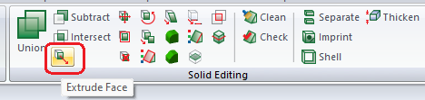

Hello, I am currently using CMS Intellicad 12.0 PE+. Is there any command that would have the same functions as AutoCAD "Presspull" command?

You can use the command SolidEdit with the option: "Extrude Face".

I tried "Extrude Face", and it works well.
