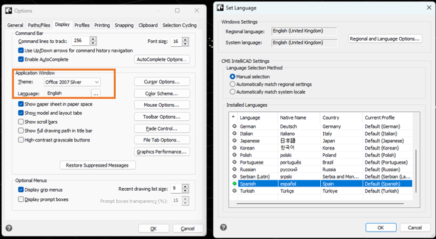

Sorry I don't have 10.0, only 10.1.
When I run the installer I always select a 'complete/full' install.
I was able to change the language on my setup to Spanish.
Options:
Display:
in the highlighted area select the '...'
then in the new window scroll down below Russian, you should find Spanish.
ICAD SPANISH LANGUAGE.png (239.05 KiB) Viewed 24305 times

Hi sln8458,
I tied again with "Complete" installation but in lengueage only appears "English".
Thank you.

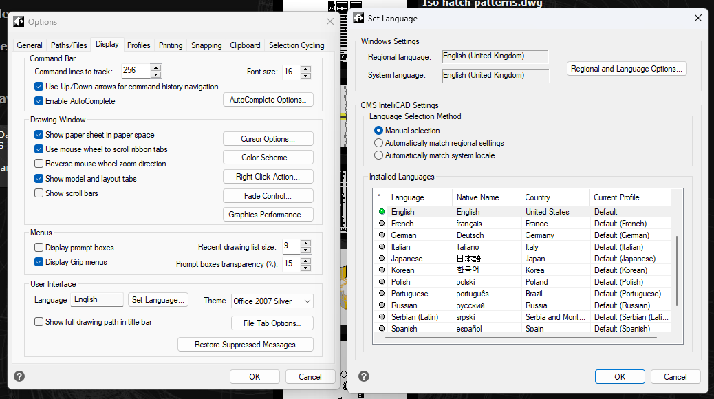

Re: Install IntelliCAD 10.0 in Spanish lengueage
sln8458 wrote: ↑
Tue Jan 23, 2024 6:09 am
I've just re-installed 10.0:
And Spanish IS available.
Sorry, I'm out of ideas, have you emailed CMS SUPPORT??
Hi SteveN, don't worrry and thank you for your time.
Yep, they say that i'm out of support.
I look in my 5 installation on my company with IntelliCAD v.10 and i can't see nothing in C:/program files / cms / cimsintellicad 10.0 premium edition / lang all people have only 1 folder with ENU (English) lengueage.
May be you have the older folders from an old installation?
Don't worries, the user affected tell me that is not a big problem.
