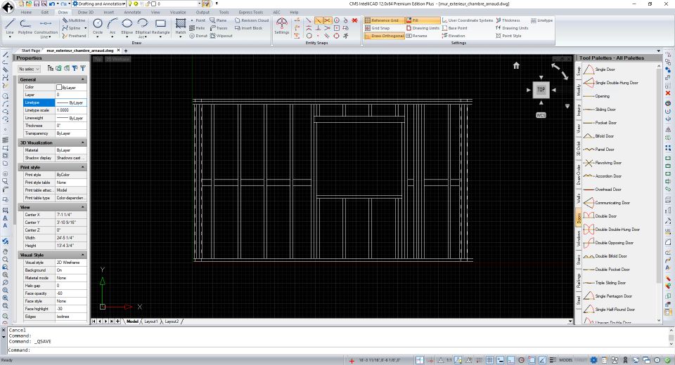

I attach my lasted worked I have done, to show that I can work, but I'm not efficient!

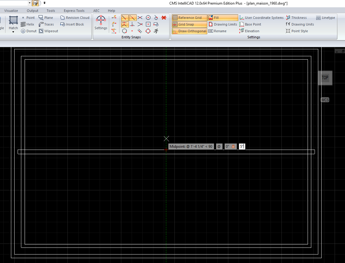

My goal with this software is to do an impresive set of plans of my house (electrical, frame, mechanical) including all usefull elevations. I want all the wall, know exactly where every stud are. Sure, I will create those plans over the year.
Right now, I have difficulty to understand how to use the "extend snap point". I try to start a line 2" (in y) from the middle of another line. I write (@ 0", 2") but the line start at the lastpoint instead of the point that I'm currently highlighting (in this case The midpoint).
What am I doing wrong?
Try to turn off the DYNMODE variable system.
Refer this: viewtopic.php?p=6780&sid=bd1218ba62b5e6 ... f87a#p6780
