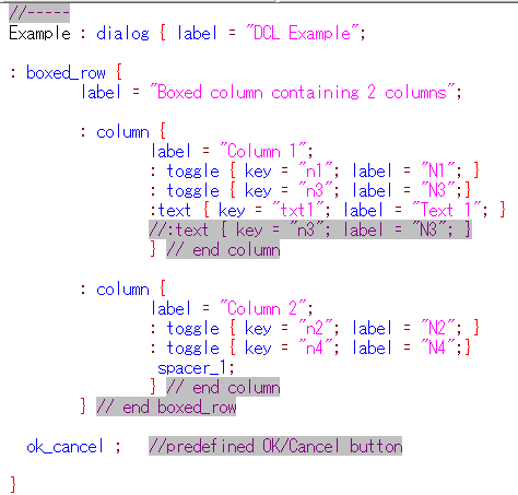

Hi Steven,
To create a box column containing two columns, please use the boxed_row tile.
I have an error when I post the full DCL code here, too. :(
boxed_row.zip
(394 Bytes) Downloaded 637 times

Thanks Quan,
As I sit here reading your post I realise how obvious it 'should' have been to me, 2 columns side by side are indeed a 'row' :oops:
Thanks :)
