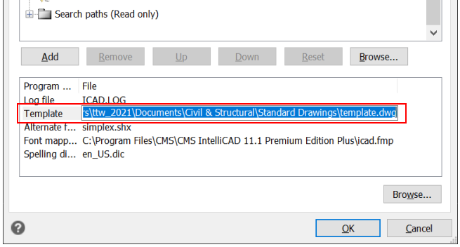

[Options] - [Paths/Files]
For example,
Re: auto load a dwt file on start up
Posted: Tue Nov 14, 2023 8:23 am
by MarkO
Changed the search path but I still get this blank screen

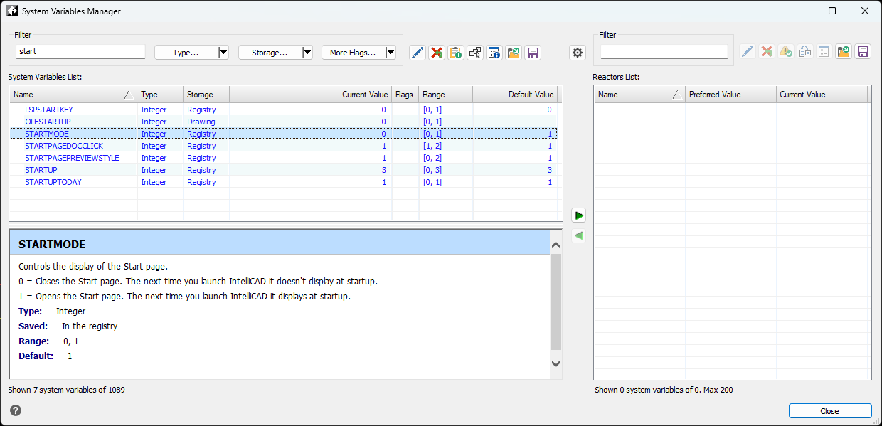

There is no option to start a new drawing on startup:
This may help though:
viewtopic.php?p=6823&sid=150162340a6f5d ... fe92#p6823
Posted: Wed Nov 15, 2023 10:08 am
by MarkO
partial solution, change the startup value to "0". It will start up as a blank dwg however it still won't load lsp files that are in the startup suite.
