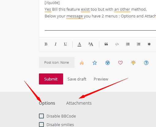

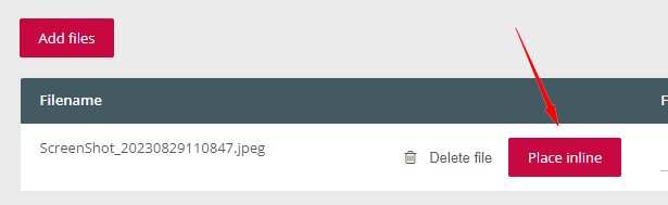

Hi Bill, I am Patrick (architect like you, i'm french)
Yes Bill this feature exist too but with an other method.
Below your message you have 2 menus : Options and Attachments
Select Attachments and Add files > navigate to your image file on your computer.
Then you will see a new Filename below. Choose Place Inline button to put the image in your text.
the location of your image in your text depends on where the cursor is when you click the button. Pay attention to that!

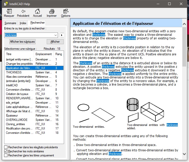

Look this House sample:
C:\Users\.......\Documents\CMS IntelliCAD11.1x64\Samples\ADT sample.dwg
1. No Project Manager for managing Architectural building levels/floors.
2. Can’t snap to elements inside a block
3. Can’t snap perpendicular to walls opposite side of building
4. Making walls/doors/windows into a block to manage as a level, no visibility settings for floor below to allow design alignments.
5. Ability to use the fillet command to cleanup wall intersections. Why not? ANY tool would be great!
1 But there are a Layer manager and you can fix the layer hight too!
Here: Format > Thickness

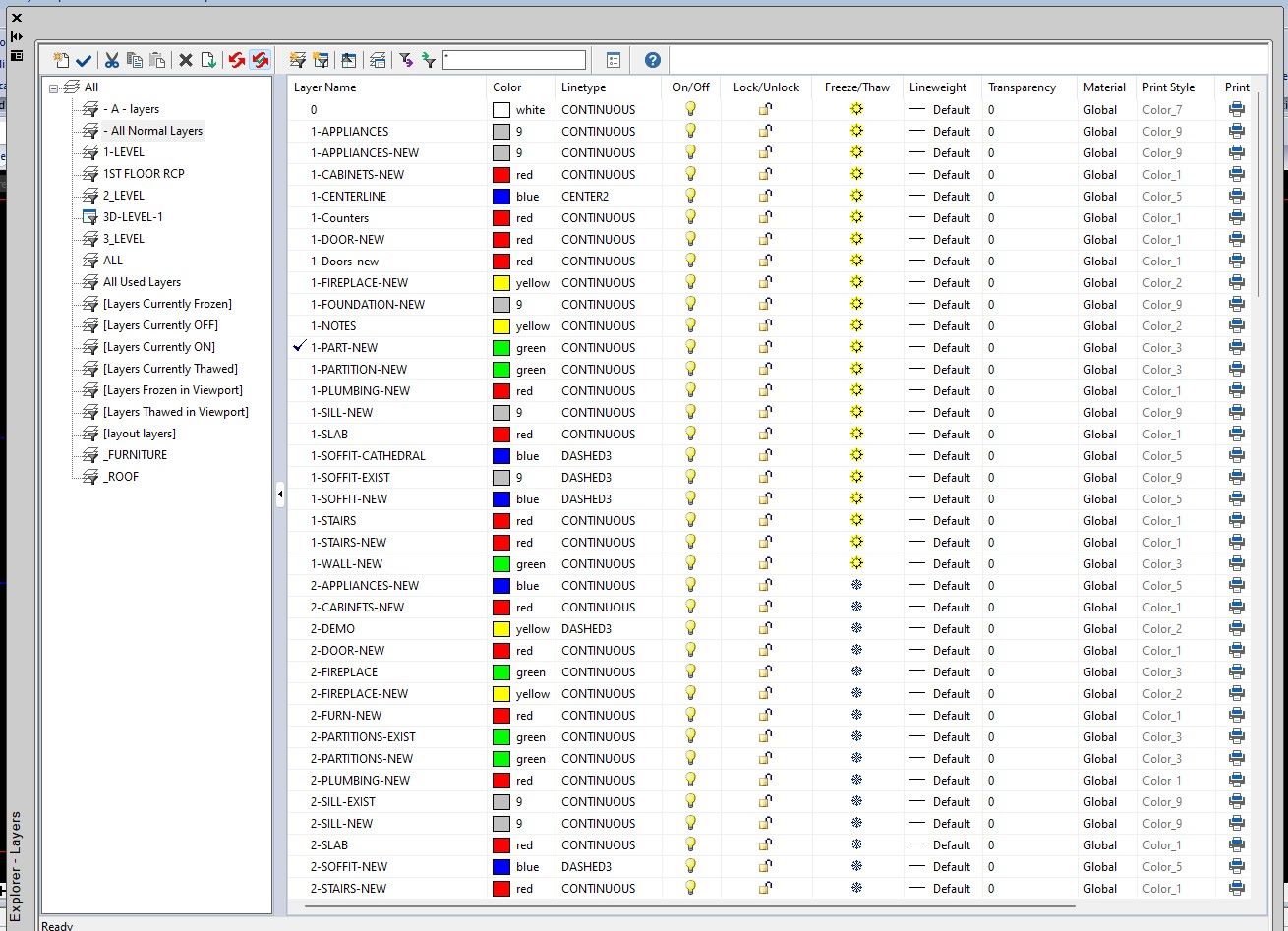

Back to Layers:
This is basically how I work, you will need to resolve your own way of working that suits you and your needs.
(sorry if you already know this)
Here is a simple layer setup:
There are 3 Xrefs, Basement / ground floor / first floor. (note: these are colour white) each attached on a layer of it's own name
Each floor has it's own model & within each model there ar 3 layers. 0 / walls / electrics. (just for simplicity)
Now if you freeze the parent layer, say first floor (colour white) ALL of the layers associated with the Xref attched on that layer will be frozen.
However you can also freeze (off whatever) individual layers within this Xref.
So you can, if you choose, turn off/freeze ALL layer except for all of the walls.
I found the Format heading with Thickness command. You can set a thickness. But it does not say what that thickness is for?! This program is going to put me in an early grave.
Re: Multi-Level Building - CAN'T DO IT? CAD For Architects.....
Posted: Tue Sep 12, 2023 12:12 am
Inexplicable_Bill wrote: ↑
Mon Sep 11, 2023 10:25 pm
Yes but now you can go to the Intellicad help menu in HELP.
AND make a search here :
(The tile here is in french because I translate the help menu in french and I havn't ended..... I am the french translator for IntelliCAD.)

Posted: Tue Sep 12, 2023 1:05 am
About how to work with layers, I use layers only for levels and/or facades.
Level1 - walls
level1 - windows
Level1 - doors
level2 - walls
level2 - windows
level2 - doors.
facade south
facade north
Section 1
section 2
etc
AND if you want to work with 3D you can add a height for earch layer and choose a thickness in plus.
so when you work on level2 layer all your item will be to this height directly.
