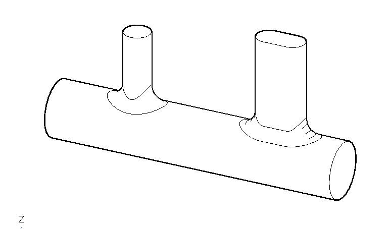

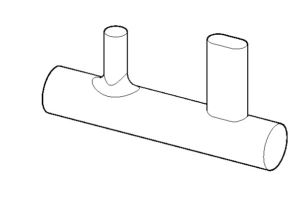

I have tried 40 times (I counted them) to get two 3D object to have a fillet between them. The vertical tapered column needs a fillet where it meets the horizontal cylinder.
1) they have been drawn as 3D solids,
2) They are all drawn off a common Z axis with the column having a Z axis appropriately placed when drawn.
3) I have followed the fillet instructions AND the Intellicad help notes.
4) The column and cylinder have been connected via the 3D Union command for solids.
5) the fillet is small enough to stay within the ends of the horizontal cylinder.
3D Fillet.PNG (39.12 KiB) Viewed 24439 times
Help please?
Thanks in advance.
Serannelo
Re: 3D Filletting
Hi Serannelo,
You are trying to create a very complex fillet, between 2 intersecting cyliners, one which I never had sucess with.
The I have done it to create the vertical cylinder as a rectangle but with the fillet on the bottom outer corner and the rotate that around the vertical 'Z' axis.

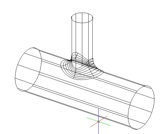

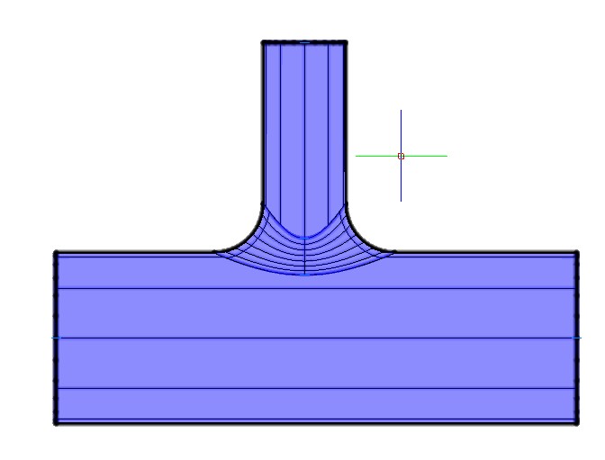

Serannelo,
I have never managed to get this to work. The image I posted was from a new drawing and the fillet did not work with that one.
Could I ask you post a video of how you did it pls.

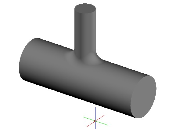

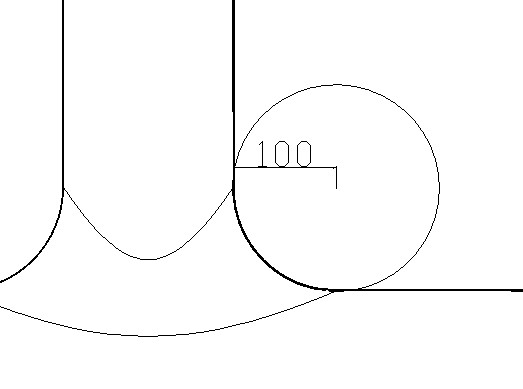

Re: 3D Filletting
Here is my test:
Commande: _FILLETEDGE
Paramètres courants: mode = AJUSTER, rayon = 1.0000
Select an edge: [Chain/Loop/Radius]: 173.1377,-775.6853,115.0000
Select an edge: [Chain/Loop/Radius]: R
Rayon du raccord <1.0000>: 100
Select an edge: [Chain/Loop/Radius]: 195.5153,-795.8752,115.0000
Press Enter to accept the fillet or [Radius]:
Re: 3D Filletting
Thanks for the info Patrick,
However all I get is a domed cylider for the first selection.
I must be getting too old for this!! :(

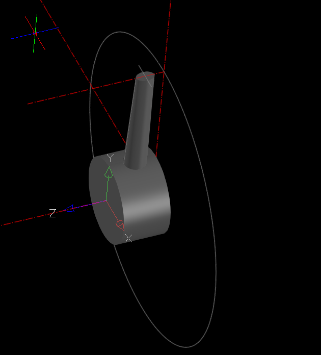

Re: 3D Filletting
#11
Commande: _LOFT
Current wire frame density: ISOLINES = 10.0000, Closed profiles creation mode = Solid
Select cross sections in lofting order or [POint/Join multiple edges/MOde]:-1249.6416,94.3915,115.0000 1 found, 1 total
Select cross sections in lofting order or [POint/Join multiple edges/MOde]:-2648.1068,1484.4956,115.0000 1 found, 2 total
2 cross sections selected
Enter an option [Guides/Path/Cross sections only/Settings] <Cross sections only>:
Commande: _union
Select entities to union: -2967.7160,-15.2055,115.0000
Entités dans l'ensemble: 1
Select entities to union: -3565.8590,123.1215,115.0000
Entités dans l'ensemble: 2
Commande:
Paramètres courants: mode = AJUSTER, rayon = 100.0000
Select an edge: [Chain/Loop/Radius]: -3151.8735,-152.0582,115.0000
Select an edge: [Chain/Loop/Radius]: -3110.0373,-108.6909,115.0000
Select an edge: [Chain/Loop/Radius]: -3046.9227,-107.1897,115.0000
Select an edge: [Chain/Loop/Radius]: -2580.2750,-1097.4169,115.0000

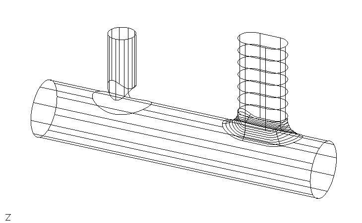

Re: 3D Filletting
#14
Thank you to both of you for your input. Spirou, I can do the examples you give but I found that when I created a tapered 3D elliptial solid with a non perpendicular axis to the mating part it would not fillet...HOWEVER......I just created a new drawing and it appeared to work. So ....I am a little bewildered.
Sin8458....I will try and do a video but I have never done one before so bear with me.
Thank you both.
