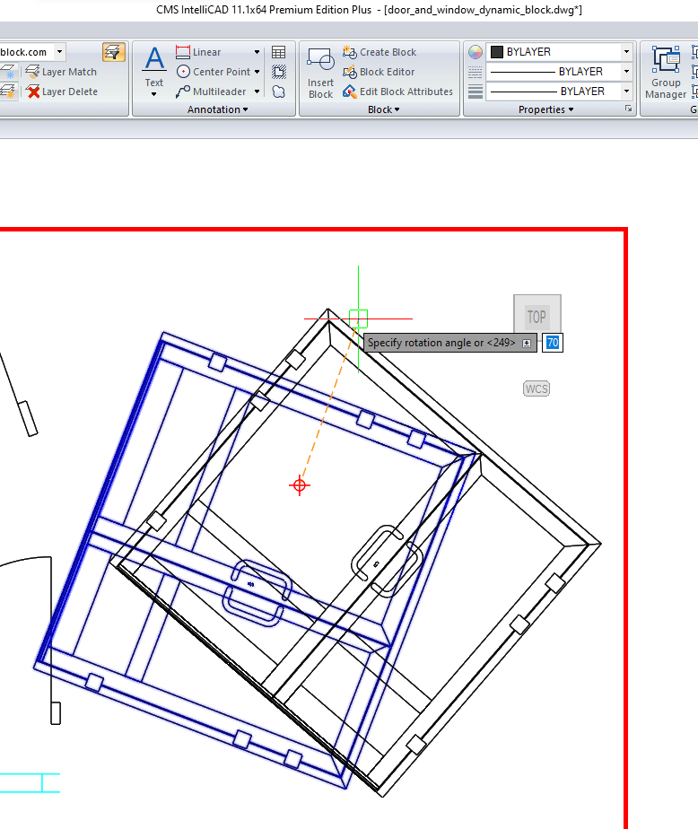

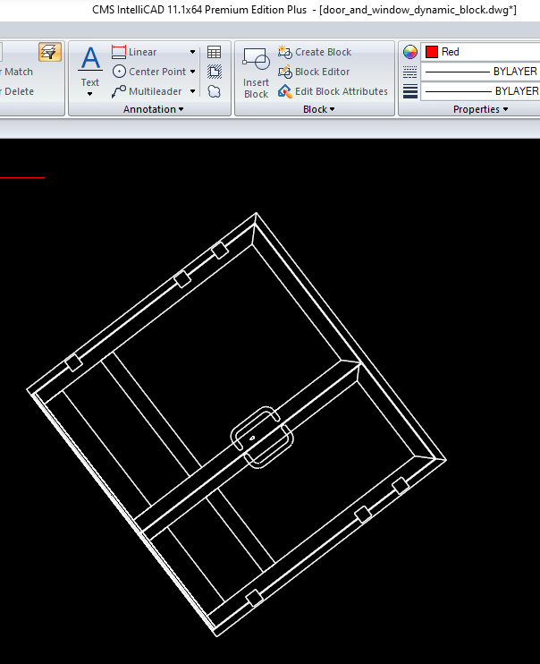

#5IntelliCAD does not support Dynamic blocks editing or creation at this point. CMS IntelliCAD dynamic blocks is in the development pipeline, and will be available as soon as possible.info@projon.be wrote: ↑Sat Aug 05, 2023 10:28 amI was expecting that CMS could create dynamic blocks and work 'easily' with dynamic blocks created in autocad.
Unfortunately, I seems that dynamic blocks can't be modified or created in CMS. Is this correct ?
Secondly, when I use the 'rotate' function on my dynamic block, the rotation works, but the block dissapears in the model tab.
In the layout tab the rotated block is visible. In the model tab, the block is visible after using then REGEN function.
Is this a bug or a problem with how the block was created in autocad?
We cannot reproduce your report about dyn blocks rotation as It works here in model space and paper space as well.
Rotating block at layouts also rotates the same block at model space, and vice versa, BUT if you stretch or scale a dynamic block then a REGEN might be required.
