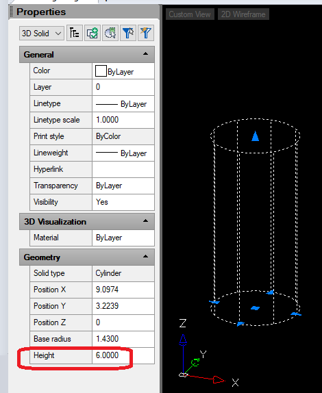

How does one change the height of a ciliinder after that it has been drawn?
For a cube one can grab one of the points and extend, but for a cilinder that is divided into 16 sections that seems not possible.
I was also looking in the properties tab if there is a height value, but I didn't find it.
In that respect, I was also looking voor de basic 3D drawing video that is specific for CMS Intellicad.
Thanks.
Re: 3D OBject height change - video tutorial 3D drawing basics ?
Posted: Thu Aug 03, 2023 6:18 pm
What version of IntelliCAD do you use?
The recent version (11) has the Height and Radius properties of the cylinder.
You can change a valid value here.

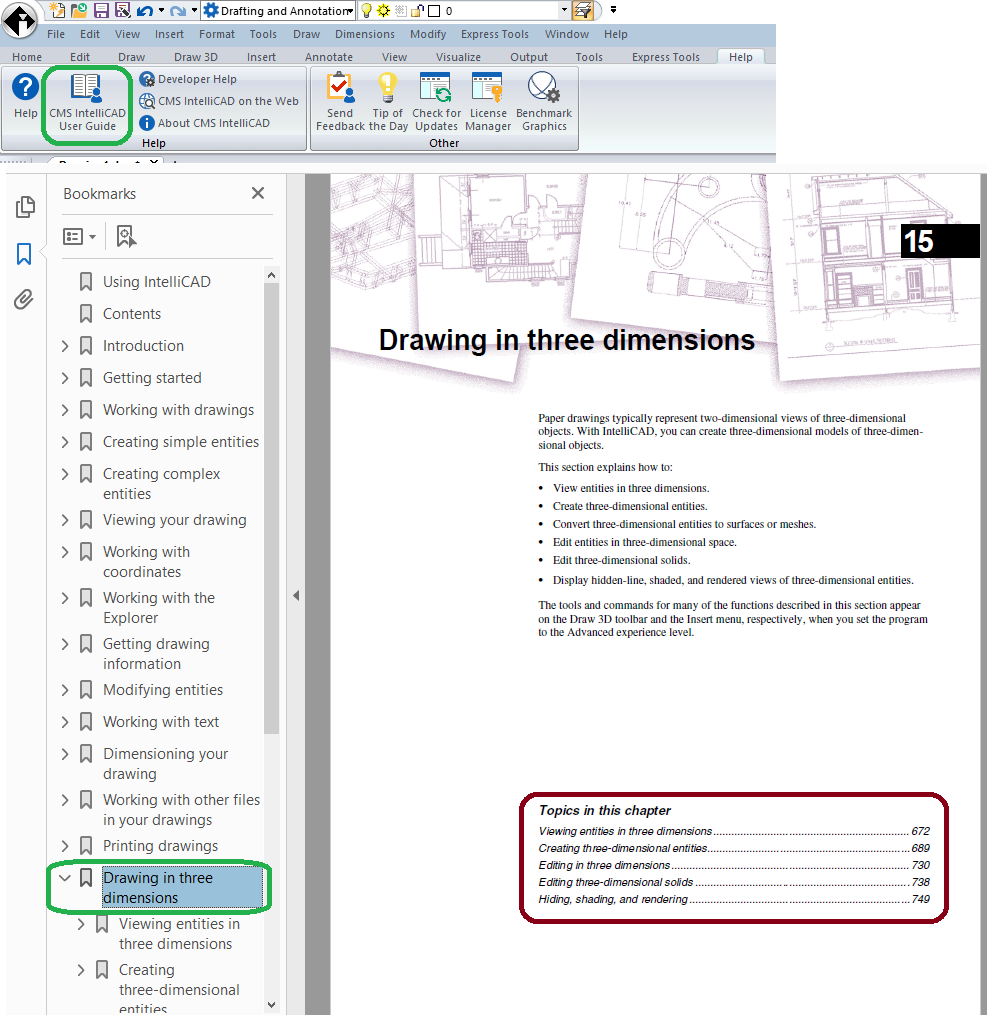

Please use the official document from CMS IntelliCAD.
Go to Help menu then CMS IntelliCAD User Guide
For the 3D object, please refer to the "Drawing in three dimensions" topic.
