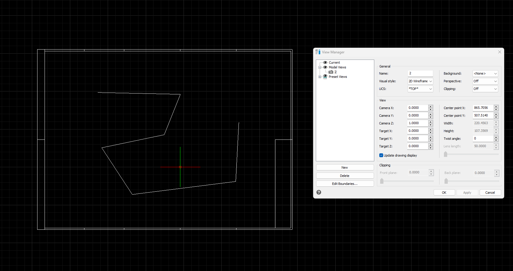

Hi, I will put here my drawing, so I created in model space my frame which I want and I created in view manager my model view I name it 2, edited boundaries. In papers space in my layout I created viewport which I want, only what is missing is to put my drawing in that viewport in my layout. I cant attach my dwg so I will post images.

On the paper space page double click inside the viewport. This opens the model space within the viewport. You can pan/zoom to your drawing in the model space and change the viewport layers to display what is desired. You can also set the scale of the window if you want the print to be a certain scale.
