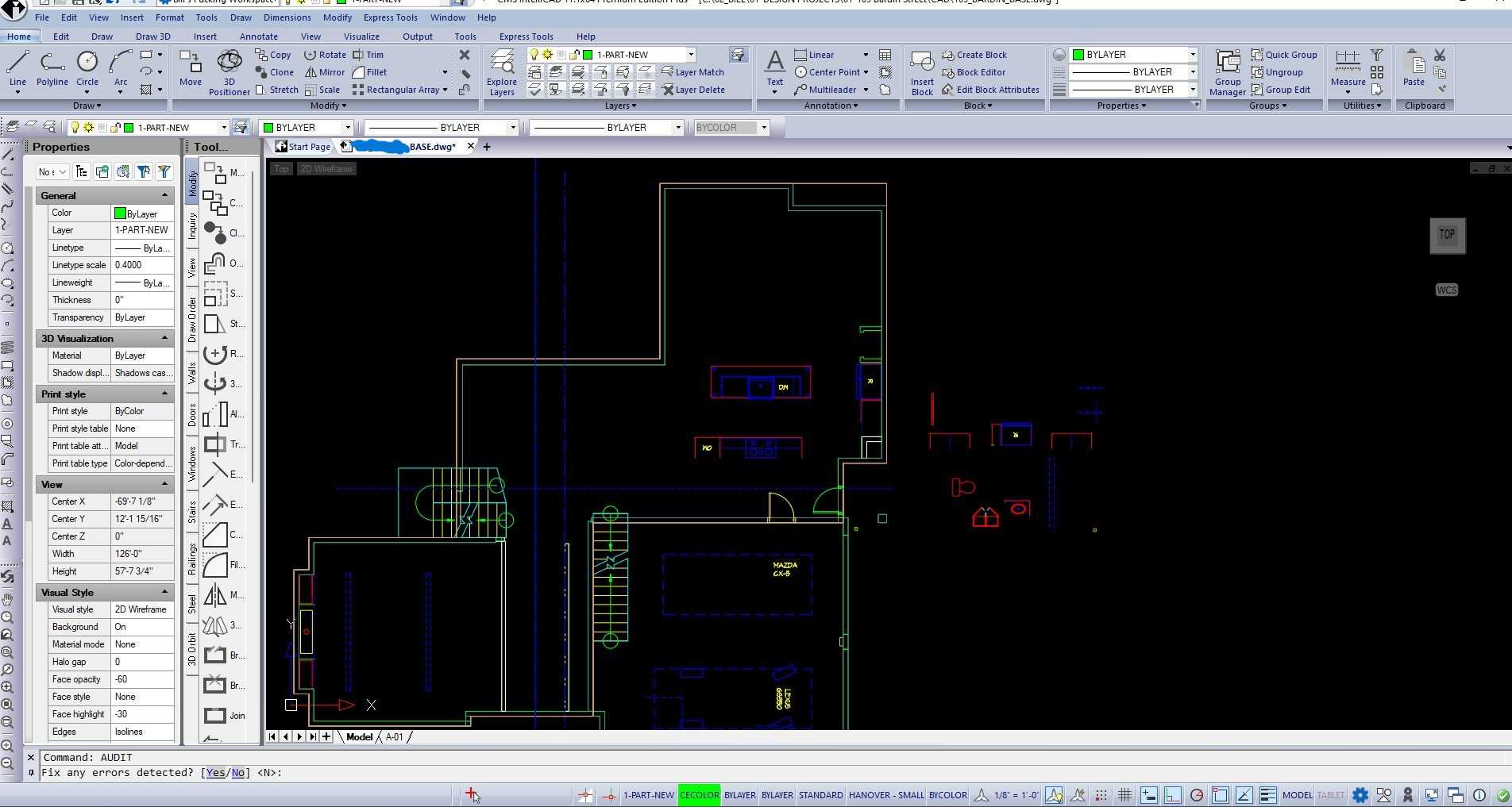

I see nobody has answered your question. I'm having regular crash problems as well. I too have a modern (1 YEAR OLD) well specified computer with plenty of processor power, a solid graphics card, updated everything etc etc. I keep finding the program closed by itself with no error reporting, when I've stepped away from the computer. Also, many many times I will execute a command, like just now I typed AUDIT and nothing happened. Nothing in my Task Manager signifies a problem. It's just sitting there, doing nothing, frozen, unable to close without forcing it closed from Task Manager. I wish there was a solution!
