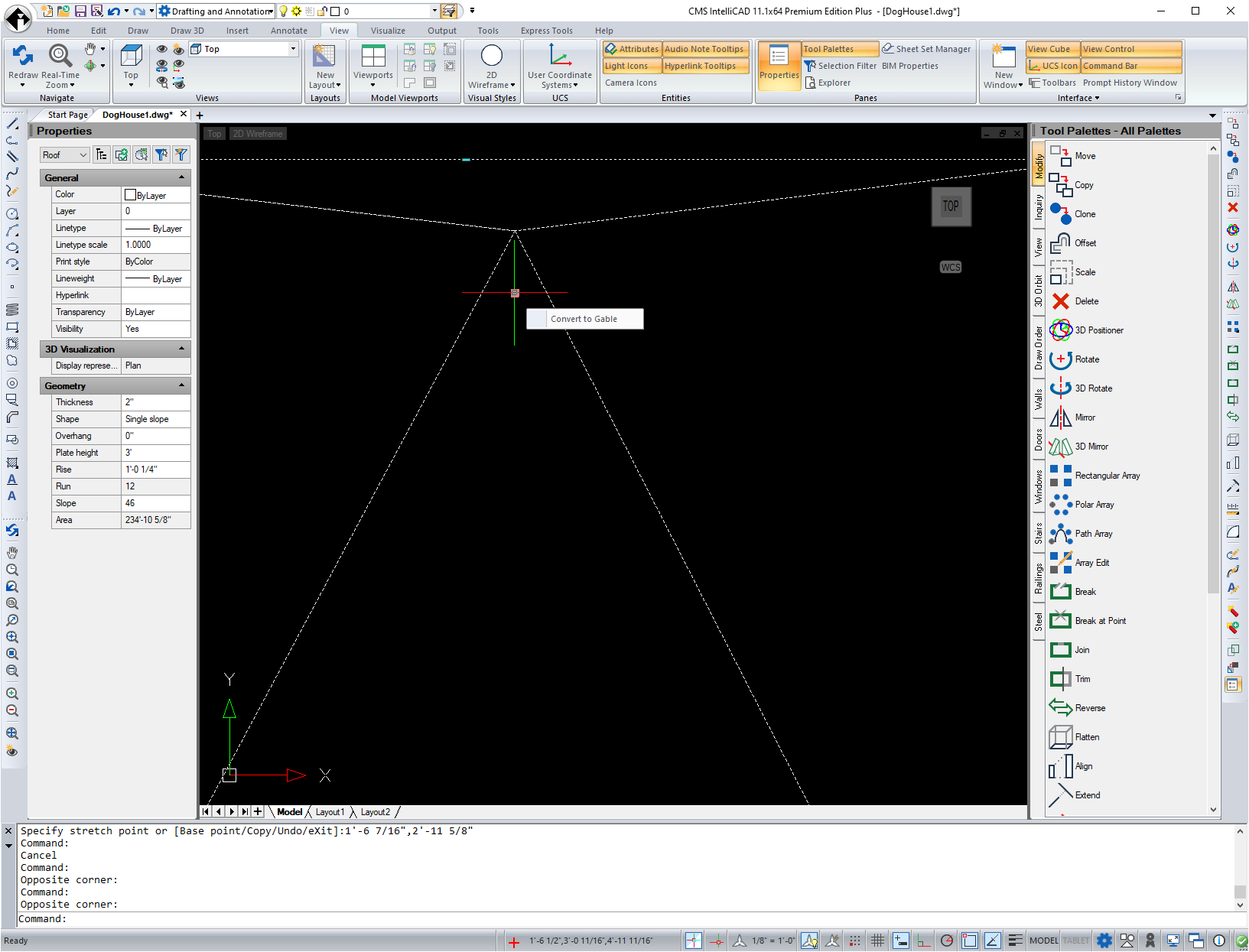

Drag center point to end where gable is desired
Step 3.png (248.2 KiB) Viewed 29909 times
escape and reselect roof point near desired gable and use down arrow to select convert to gable
Step 4.png (222.79 KiB) Viewed 29909 times

Would not accept the actual drawing, but to create initial drawing:
1. draw square (I used draw line 0,0; 0,36;36,0;0,-36;close
2. then used convert to wall and converted what I had to walls
3. select the roof and anchor a point at each corner of the walls I just drew
4. I then tried to convert an end to gable. I have not found a good set of instructions so just guessing here.
a) I selected the center point and dragged it towards the top wall.
b) I then reselected the roof and the draggable point nearest the end I want to be a gable give an option "Convert to Gable", using the down arrow I selected this and press enter
c) Intellicad crashes and I send the crash report
If there is a better way, please share the correct steps to get a gable roof. It does seem that in some cases I can get the gable, but it is not consistent.
