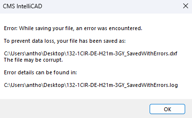

Hi everyone, I am new in iCAD.
Just starting to use iCAD PE 11.1 for couple days. However, I am constantly experiencing file corruption error when saving (see figure below). This problem has been really annoying and impact my every day work significantly, because every couple hours the error pop out. I have been trying to reinstall the program, update the graphic card driver, even using greater version PE+, but no luck. I remember the most time the problem coming out when I was trying to manipulate and edit viewports in layout.
2023-03-02 22_34_55-CMS IntelliCAD_file c.png (6.98 KiB) Viewed 18511 times
My laptop configuration:
- AMD Ryzer 7 5800H.
- 32gb RAM
- GFORCE RTX 3060.
- NVme 1GB.
- WINDOWS 11 HOME.
Any help is highly appreciated. Thank you!

Sorry I don't have an answer for you. I get the same error message from time to time, last one yesterday when finishing for the day.
I run 11.1 PE + on an i9 12900 64Gb 3060 8Gb win11pro.
I reported the problem, as always, hopfully you did the same and they will find the bug causing the issue.

I'll be honest.
YES I have had this before, in a number different versions, it's why I have autosave at 15 mins, to limit any potential loss of work.
Also, if you get the error, don't close until you have opened the saved with error file. I have had a few where the saved with errors file has stuff missing and you can still copy/paste from the orginal before you close, again minimising data loss.

I think I have mentioned this before but when I had a large 3D drawing start crashing on me a lot, I opened a blank drawing, opened my problem drawing and cut and pasted ALL from the problem drawing to the blank drawing and then saved it. All the problems went away. corrupted database as a guess. Can't hurt to give it a try.

happened again today:
Managed to save my work by opening the last $SV file and copy/paste the missing stuff.
Icad would not close the corrupt drawing, had to use the 3 finger jiggle (task manager)

The most error windows came out are when I was editing something inside and outside the viewport in layouts. I was trying to click into the viewport and go out by clicking in the paper sheet, then I realized that I couldnt go back to the paper space and the program crashed when saving. It could be alleviated before every time editing the viewport, save and close it then open it again, after doing this the program can hold couple rounds before the problem comes back again. If you don't touch the viewport, the program seems to be more stable.
