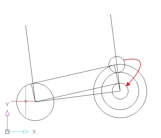

What are the keystrokes please. to activate the tanget command to click on one circle and create a line to then click to the next circle to drop the line to the circle and thus a tangent created. Was much easier in autocad. Is this not a simple functiuon in Intellicad 11.1?
Thanks.
Re: Drawing a tangent between any two circles
Posted: Fri Feb 17, 2023 5:54 am
Ctrl + right click to choose the snap help !
And use the tangente snap help to draw your line....
Posted: Wed Feb 22, 2023 8:11 am
by Serannelo
Hi, thank you for your reply. It explains perfectly how to create/construct a tangent . I understand this method but was looking to see if there was a method similar to autocad whereby you right click to pull up a menu, click on tangent, pick a point on the first circle and click then it auto draws a line to the next circle onto which you click again and it auto joins. HOwever, I see you are a veteran user and would have already sussed it out if that were available so my question is answered so I do thank you. At least I know now for sure. (merci beaucoup?) :-)

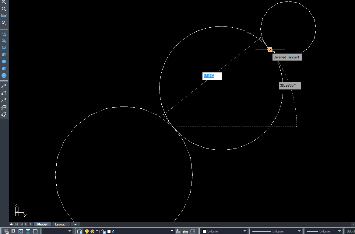

Posted: Wed Feb 22, 2023 9:17 am
Hi Richard,
Have a look at this video.
-> https://www.dropbox.com/s/a8szm7n9cxgof ... 2.avi?dl=0 <-
to get the selection menu to display within an active command press ctrl + right click together, ie hold down ctrl and right click.
Give it a whirl :wink:

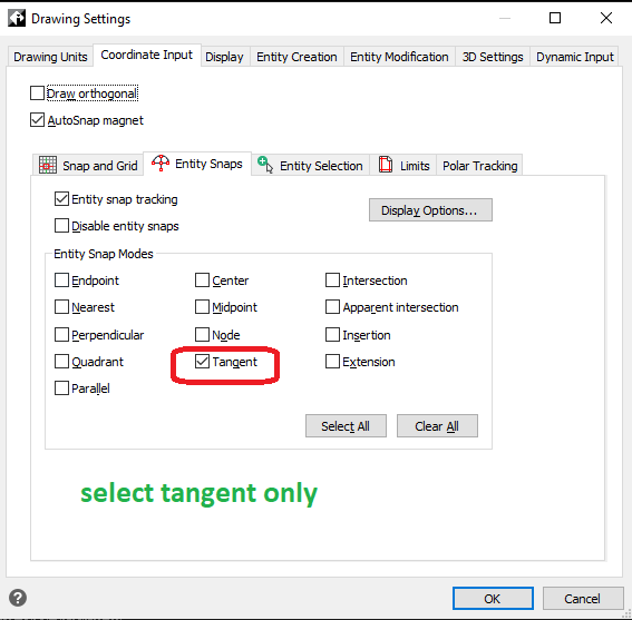

Hi Richard,
You can also set the Snap to Tangent only, then throw the command "line".
Osnap Tangent.png (17.11 KiB) Viewed 12150 times

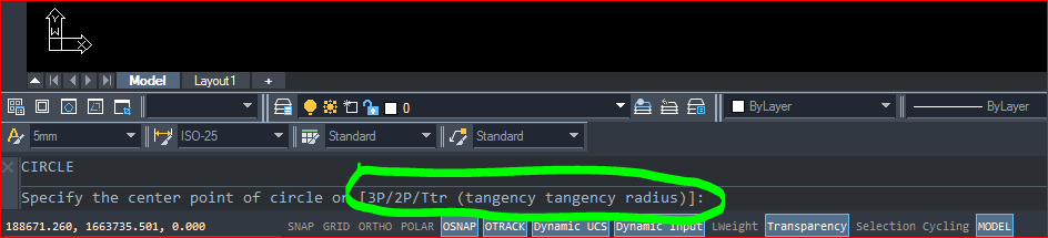

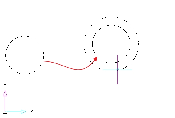

Olá Seranelo!!!
Caso o esperado seja isto....:
CIRCLE 3.png (22.84 KiB) Viewed 12141 times
Ctrl+9 ativado, aparecerá 3 opções....
CIRCLE 1.PNG (15.48 KiB) Viewed 12141 times
Ative o comando '2P'
Pronto.
