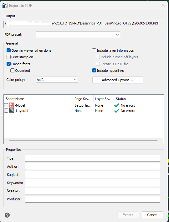

Hello,
Is there a way to export PDF in silent mode?
I would like the window not to appear and the "model" option to be configured.
