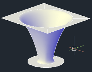

Want to make that in IntelliCAD. How please?

I used it to make the two top and bottom but then I can't use Loft with the result on surface.
It's easy between 2 circles but here top and bottom are merged with the trunk.
It's why I tell my question.... Thks for your reply.

Like this?
Top is a solid rectangle, with a solid disc subtracted.
Bottom is a solid disc with a smaller disc subtracted.
Cone shape is a closed polyline, fillet radii, 'revolved' about the centre axis

Yu're right Steve your proposal answer is interesting but you use the Revolve tool wiyh a face and not the Loft !
But you have created 3DSolid, I havn't try this idea. Thks
