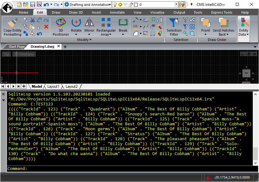

Great job on the ICARX wrappers. My SQLiteLsp routine compiled without issue.
So I’ve included a build (SQLiteLspIC11x64.irx) at https://www.theswamp.org/index.php?topic=28286.0
There’s few samples in the package, plus the development history at the swamp thread
(DEFUN C:TEST123 ( / a db)
  (SETQ DB "E:/chinook/chinook.db")
  (DSQL_OPEN DB)
  (setq Q "SELECT
	trackid,
	tracks.name AS Track,
	albums.title AS Album,
	artists.name AS Artist
   FROM
	tracks
   INNER JOIN albums ON albums.albumid = tracks.albumid
   INNER JOIN artists ON artists.artistid = albums.artistid
   WHERE
      artists.artistid = 10;")
  (SETQ A (DSQL_ASSOCQUERY DB  Q ))
  (DSQL_CLOSE DB)
  A
SQliteLisp for CMS.png (101.85 KiB) Viewed 10833 times
</p>
Note, this is free, open-source software, I can only make fixes until my trial period ends. Enjoy!
