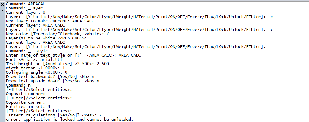

(defun c:areacal ( / js nb ent dxf_ent ptlst surf n AcDoc Space old_textsize count app_txt cum_area pt_ins val_txt lst_bis l_4d max_d pos pt1 pt2 pt3 d1 d2 nw_obj ent_text key)
       (command "_layer" "_m" "AREA CALC" "_c" "7" "" "")
-=(RLH)=-
Re: Trapezoid area lisp
This code is weird, you must select the item your-self?
I try it in French UI but I can't understand how it work.....I will try in US UI.
Explanations:
1 layer creation
2 go to the new layer to write
3 choose the style of the text
4 ask if you write the text backwards
5 ask if you write the text upside-down
6 select the items
7 ask if you write the calculations
8 "error: application is locked and cannot be unloaded." ???

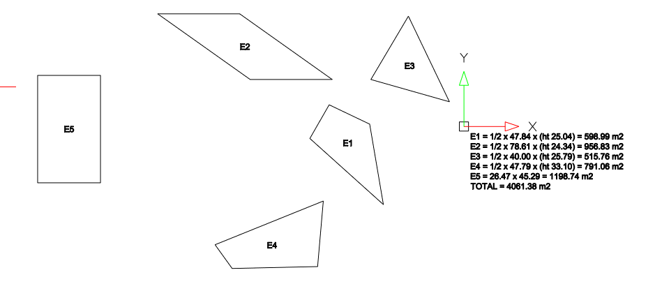

ProM wrote: ↑
Sun Dec 11, 2022 4:27 pm
Hi SPirou4D. This code select close polylines rectangles and triangrles and insert calculate the area, and insert text with analytic calculation of this areas. I want to add in this code to calculate the area of trapezoid, with the type E = 1/2 x (a+b) x h . Can any one help?
Thanks
Do you want something like this? (E3 figure)

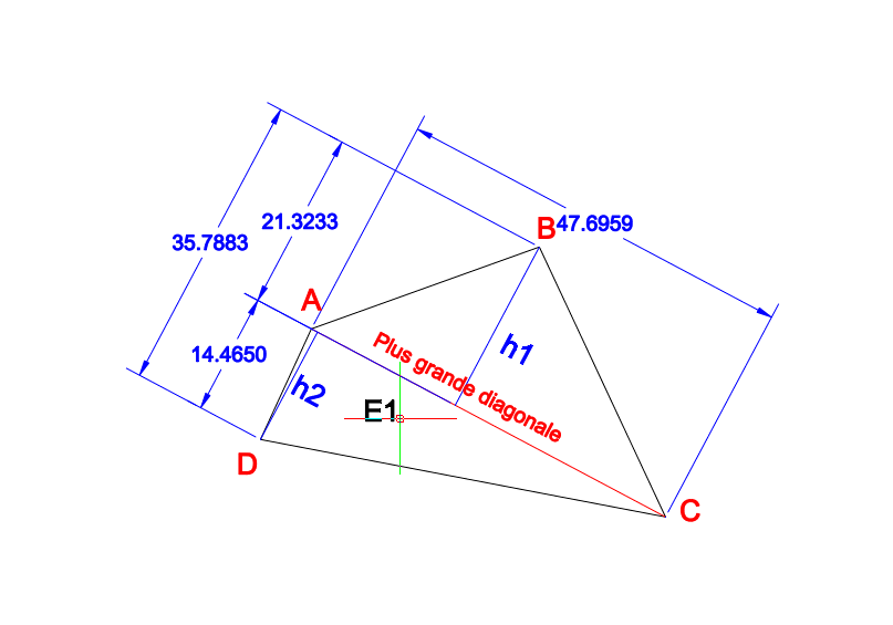

Here is a real trapezoid =
For me, Trapezoids area is triangle ABC area + triangle CDA area
E1 = 1/2 x (h1 + h2) x largest diagonal
Example here :
E1 = 0.5 x (35.78 x 47.69) = 853.47
So you look for the largest diagonal
and in the code, line 46-79 there are triangle calculation, you can re-use it two times.....
Good luck !

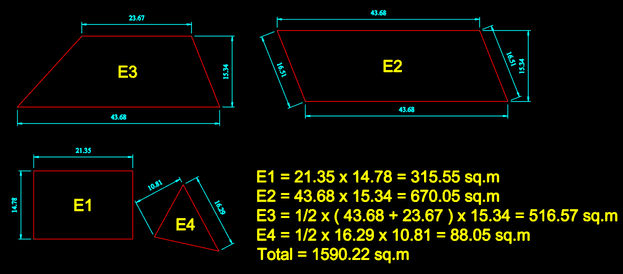

Here is my new script for your demand :

									; trapezoidals
									(progn
										(setq
											diag1 (distance (car ptlst) (caddr ptlst))
											diag2 (distance (cadr ptlst) (cadddr ptlst))
											diag (list diag1 diag2)
											max_diag (apply 'max diag)
											pt1 (if(> diag1 diag2) (car ptlst) (cadr ptlst))
											pt2 (if(> diag1 diag2) (caddr ptlst) (cadddr ptlst))
											pt3 (if(> diag1 diag2) (cadr ptlst) (caddr ptlst))
											pt4 (if(> diag1 diag2) (cadddr ptlst) (car ptlst))
											d1
											(distance
												pt3
												(inters
													pt1
													pt2
													pt3
													(polar pt3 (+ (angle pt1 pt2) (* pi 0.5)) (distance pt1 pt2))
													nil
											d2
											(distance
												pt4
												(inters
													pt1
													pt2
													pt4
													(polar pt4 (+ (angle pt1 pt2) (* pi 0.5)) (distance pt1 pt2))
													nil
											ht 	(atof (rtos (+ d1 d2) 2 3))
											surf (* (atof(rtos max_diag 2 3)) (atof (rtos ht 2 3)) 0.5)
											cum_area (atof (rtos (+ surf cum_area) 2 3))
										(strcat
											"E" (itoa (setq count (1+ count))) " = "
											"1/2 x "
											(rtos max_diag 2 2)
											" x (ht "
											(rtos ht 2 2)
											(rtos surf 2 2) " m2\\P"

BUT I can't remove to this problem :
error: too few arguments
nil
If someone can help me to correct this Please !
