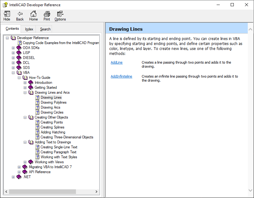

You can refer to the sample code in the official document and then modify the VBA code to fixed with IntelliCAD.
BTW, here is the IntelliCAD for changing the selected objects to red color.
