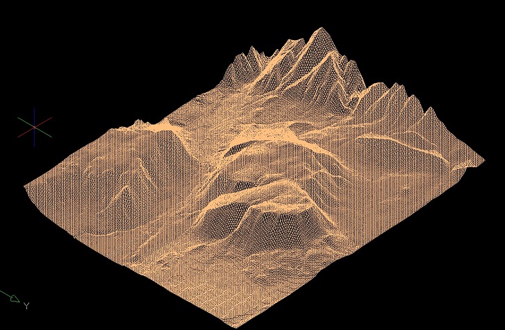

My First IRX routine, maybe useful for someone. I tried to attach it here but, I can't so I put it on my google drive
contains source and binary for 10_1, the command is make tin.
https://drive.google.com/file/d/1z4fCDD ... sp=sharing
