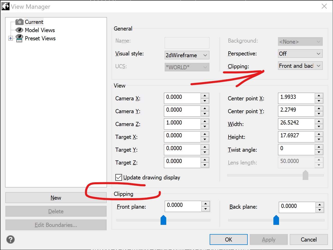

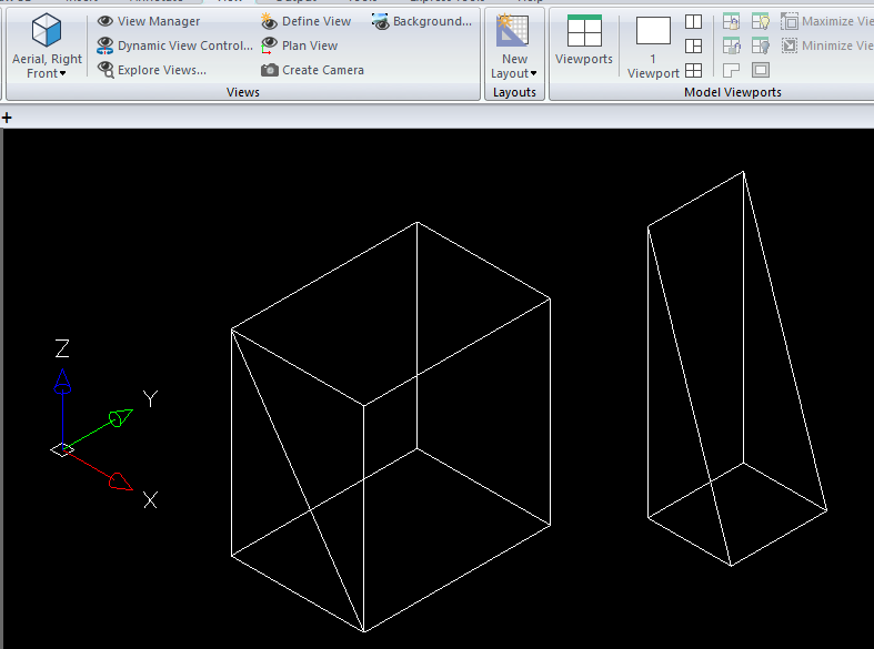

In fact this may sure be an issue with user drawing and user needs to check if the specific drawing VIEW settings are already setup to clip views with custom values.
On such drawing, use VIEW command to verify the clipping values.
