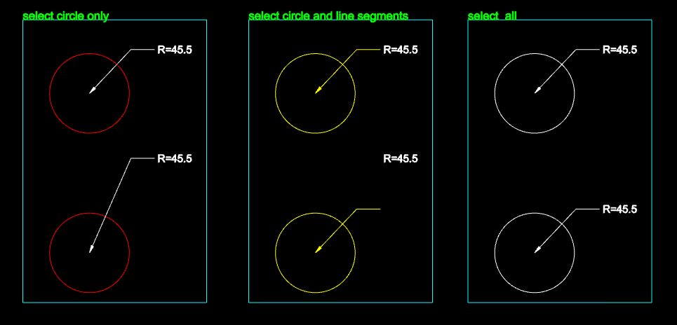

#3Hi,
I don't think that's an issue.
Depend on what object selected, the results differ.
Refer to the below image.
- Move_leader.png (18.45 KiB) Viewed 8023 times
Re: Text of a moved dimension stayed behind
No matter how I move or copy, the text does not move or now it even moves somewhere else. I need to move the text separately. It happens only for Circle dimension, practically every circle dimension. I am getting a phobia with this.
My steps :
1) I would select multiple items (including the circle and dimension) by using the left mouse button
2) I choose the base point by clicking right button and left button
3) I then drag all items to the new location. Every item is seen to be moving.
4) I click the left button again at the second point or the destination.
5) Except for the text and leader, every item has moved in tandem. The text and leader may stay at the same spot or it may move to another different location quite far
away.
6) I would have to then move the text and leader separately to the new location.
