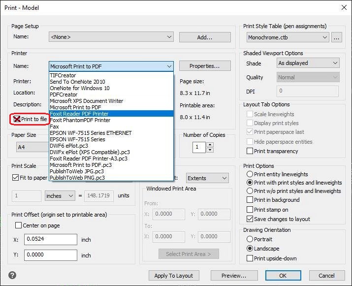

Just a thought, but have you 'ticked' the print to file' box?
Located in the print dialogue, just to the left of my highlighted printer below (Foxit Reader....)

I have reinstalled. It is okay now. Thank you.
