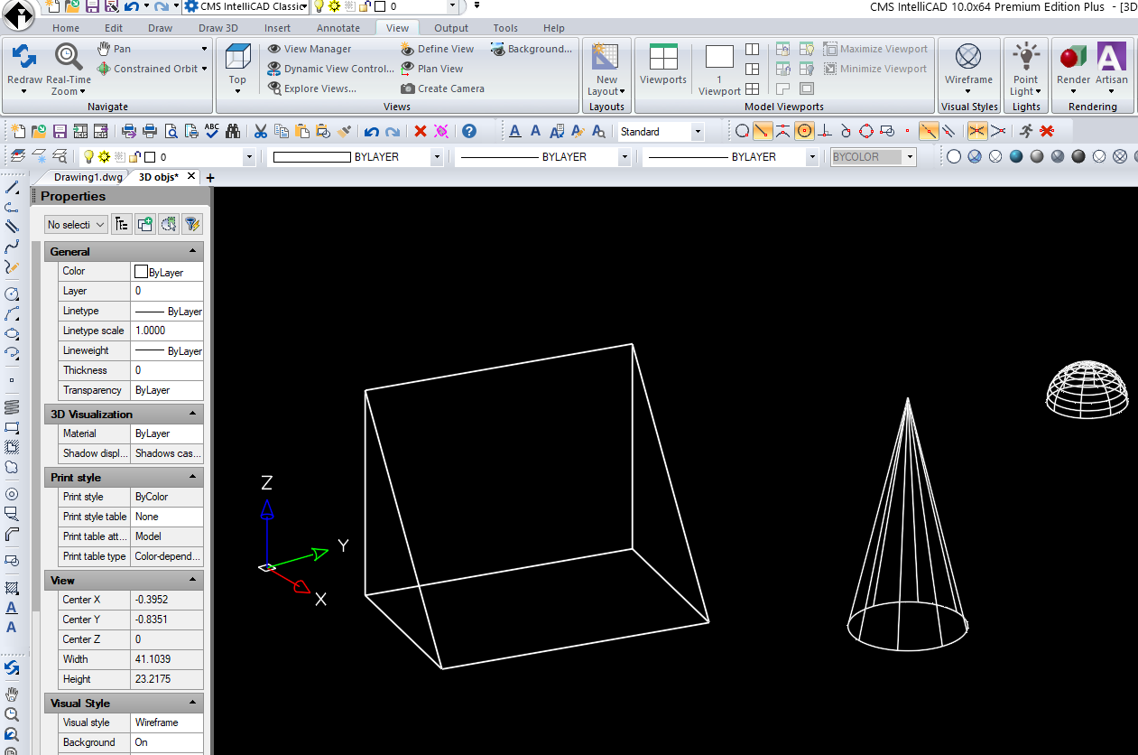

I have installed IntelliCAD PE plus as a trial. Used all default values for display etc. I am unable to see lines after they are drawn. Can select them and they become visible however if unselected they are not. If I change the background to white I can see the lines but they are faint. This is for all colours.

The issue seems to be with the visual styles 2D Wireframe'' and Wireframe''. Both of these visual styles result in all lines being difficult to see. On white you can just see them. On black background, they basically vanish. Overall the visual styles in IntelliCAD are rigidly set to only 10styles. Some autolisp commands do not work so the styles cannot be customised etc. Overall I can't find a solution. I would like the wireframe visual style to display basic lines. The closest I can get is 'sketchy' but the sketch affect is not suitable. Also this results in strange overlaps on the corners of solids and 2D shapes.

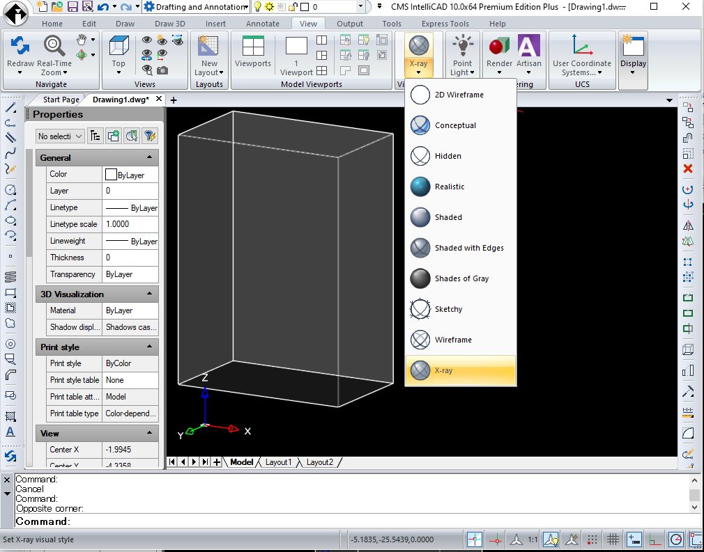

You can use the command "vscurrent" or select the "Visuals Style" in the View menu.

Hi, this does not help. The '2D wireframe' and 'wireframe' visual styles are not visible on a black background. Well at least on my machine they are not.
Customisation is not possible? Can I create my own visual style? None of the styles available under 'vscurrent' are suitable.

The X-ray and WireFrame work on my PC.
