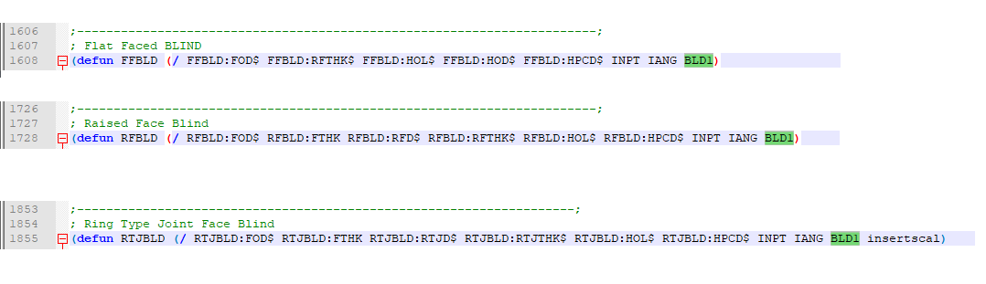

You're missing between the global variable and the local variable.
In the SLN_PIPING.lsp, you use the BLD1 as the local variable so after the function finishes running, the local variable value is automatically discarded, which means that the value of BLD1 will be NIL.
Please erase the BLD1 symbol in the definition of functions: FFBLD, RFBLD, RTJBLD then try again.

Hi Quan,
Thanks for the info, unfortunately it has made no difference.
(defun FFBLD (/ FFBLD:FOD$ FFBLD:RFTHK$ FFBLD:HOL$ FFBLD:HOD$ FFBLD:HPCD$ INPT IANG#); BLD1)
(defun RFBLD (/ RFBLD:FOD$ RFBLD:FTHK RFBLD:RFD$ RFBLD:RFTHK$ RFBLD:HOL$ RFBLD:HPCD$ INPT IANG); BLD1)
(defun RTJBLD (/ RTJBLD:FOD$ RTJBLD:FTHK RTJBLD:RTJD$ RTJBLD:RTJTHK$ RTJBLD:HOL$ RTJBLD:HPCD$ INPT IANG insertscal); BLD1 )
