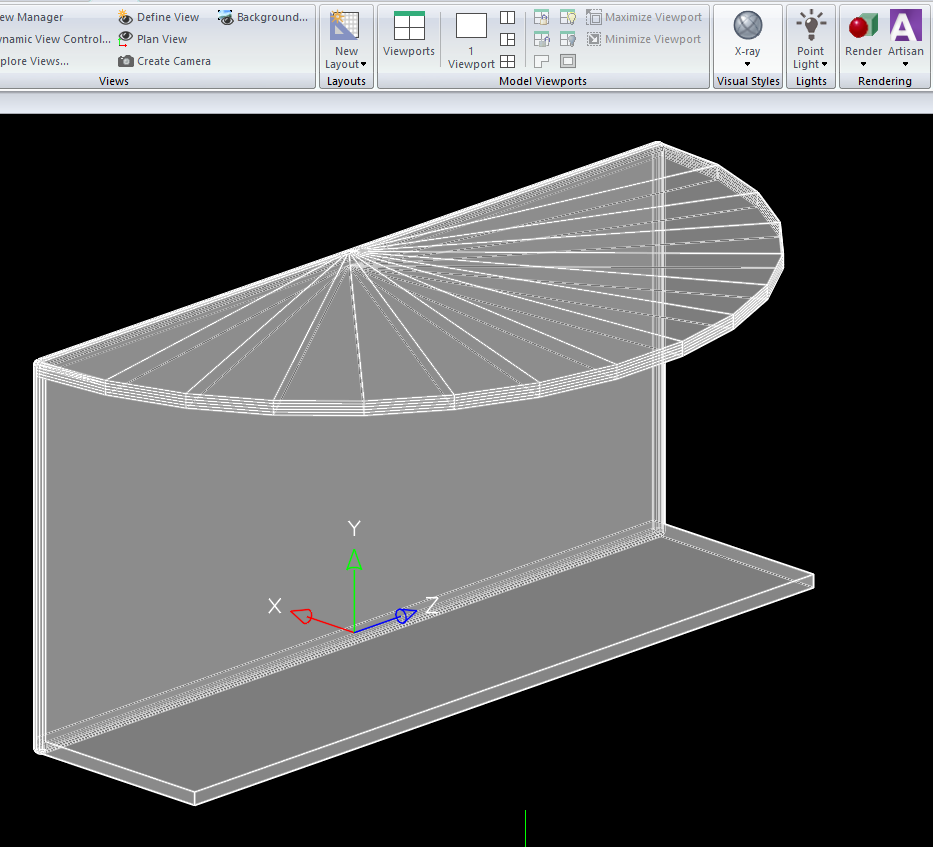

#4I've added one of the drawings producing this error
My intellicad's _VERNUM = "10.0.1110.116340.PE+.VC15.x64.CMS100" (read only)
- QWE.zip
- (23.95 KiB) Downloaded 183 times
Re: Not opened for read
#5I'm using Icad 10.0.1491.119529.PE+.VC15.x64.CMS100a
So there is an update available, which I suggest your install.
(note: I am only a user, not associated with CMS)
Here is your drawing modified by me.
Steve
Steve

#7Hi Quan,
Yes only one object, but can you modify the drawing? as this appears to be the OP's problem.
