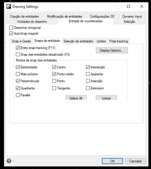

Como utilizar/habilitar o OSNAP em comandos criados através do VBNET.
Minhas ferramentas não funcionam com OSNAP/ESNAP.
O rastreamento polar também fica desabilitado.
O uso das teclas F10/F3 ou opções na barra de ferramentas não habilitam OSNAP/ESNAP, embora seja visível na barra de status que estão habilitados, na tela não selecionam.

I am trying to use OSNAP/Polar inside a VBNET command.
When I run the command, the OSNAP/ESNAp os objects does not is available.
OSNAP/ESNAP is available only in native commands.
Or, there is some variable to set when command begins ... or some SYSTEMVAR is missing inside command.
I tryied examples in package os CMS but nothing difrent or new ... I really believe I am missing somethig ...

#5PS.: I also tryied to set SYSTEMVAR("OSNAP") but it´s not usefull ... simply doens't select object snap in any option.DenisSilveira wrote: ↑Wed Dec 02, 2020 9:23 amSorry about that.QuanNguyen wrote: ↑Wed Dec 02, 2020 9:10 amHi,

#10Simply doesn't work.
see my Drawing Settings - snap
- snap1.jpg (70.71 KiB) Viewed 36141 times

But commands called inside my linecodes doesn't. This makes me believ there is something ocurring during the interval time to call command and code to run, because object in window seems to be invisible.
All of my commands in Acad is not working properly because depends of snap many times.
I bellieve there is some missing config anyway ...
May I need to explain that native commands like "line" (for simple) shows the grips for snaps defined in my config.
Re: OSNAP / Rastreamento polar
#12Just In time.
I tested your linecodes inside completly new app and works !!!
I need to find where is the bug ...
#14I had tryied many options. I descovered that calling <CommandMethod> directly is usefull.
When I call lineVbNet by form button or form menu the snaps is not working.
Calling CommandMethod goes directly to the window.
Calling by button or menu I need a first click to select the window and it's not also snaps working.
Keep going ... any sugestions are welcome.
