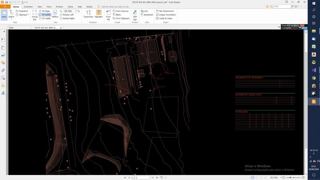

It doesn't plot correctly. Background is black and Paperspace does not plot. Lines are confused and text dos not plot.

The result is a black drawing in PDF file.

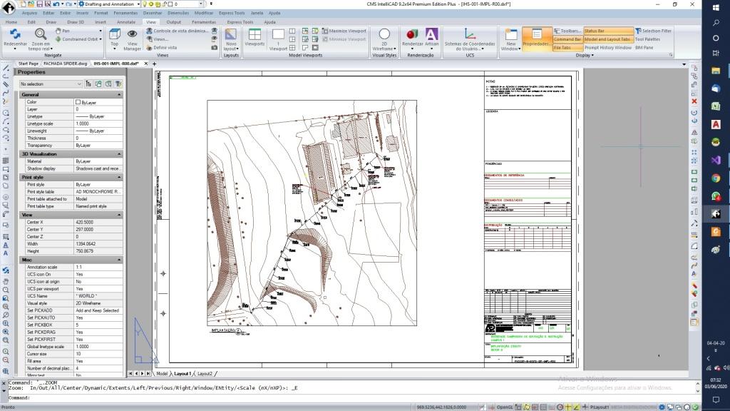

File to print

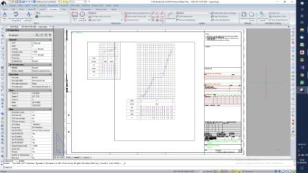

Result
Config screen:
