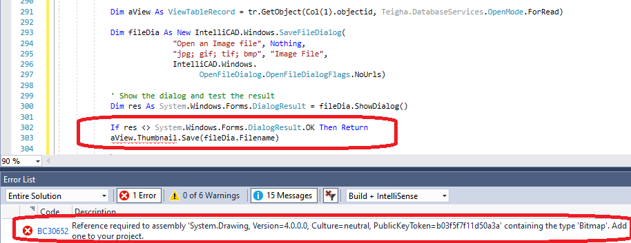

Also, line code :
Dim fileDia As New IntelliCAD.Windows.SaveFileDialog(
"Open an Image file", Nothing,
"jpg; gif; tif; bmp", "Image File",
IntelliCAD.Windows.
OpenFileDialog.OpenFileDialogFlags.NoUrls)
Causes this problem.
Code line "aView.Thumbnail.Save(fileDia.Filename)" generates an error because aView.thumbnail is set to nothing.

DenisSilveira wrote: ↑
Mon Jun 01, 2020 12:04 pm
Also, line code :
IntelliCAD.Windows.
Please add the assembly System.Drawing to your project then it works.

QuanNguyen wrote: ↑
Mon Jun 01, 2020 6:16 pm
Also, line code :
IntelliCAD.Windows.
It is not even compiling ... not running ... the problem is to identify "Intellicad.Windows" to compiler
