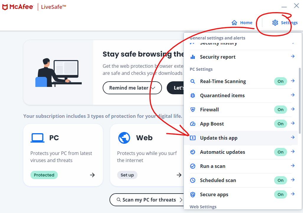

At McAfee, go to Settings > Quarantined items and restore EKAG6420.exe (do not delete it otherwise a CMS IntelliCAD uninstall and reinstall is required);
At McAfee, go to Settings > real-time scanning and exclude EKAG6420.exe (*) from real-time scanning;
At McAfee, go to Settings > Update the app > Check for updates as seen at the image below.

Run CMS IntelliCAD again and the issue should be resolved.
