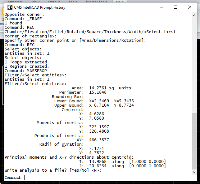

MASSPROP is ONLY available at CMS IntelliCAD PE PLUS version because it's a feature related to solids and regions.
