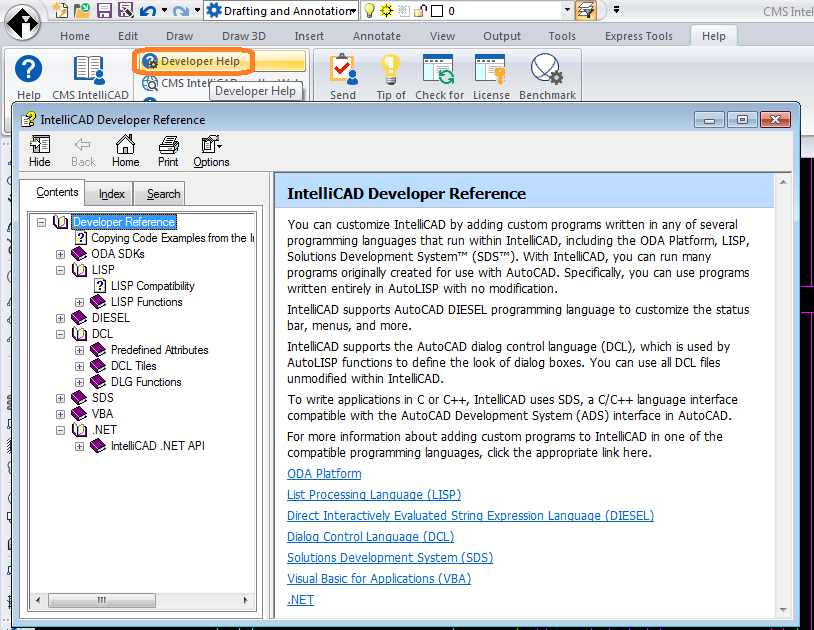

#4Hi Spirou,
Please go to the menu Help then select the "Developer Help" or "HelpDev" command to see the documents of IntelliCAD for the developer.
Regards,
Regards,
Re: Break and Split Curve.
#5Thks Quan,QuanNguyen wrote: ↑Thu Jan 20, 2022 7:15 pmHi Spirou,
Regards,
Very good help indeed..... I didn't know it.
I go to read..... At soon.
